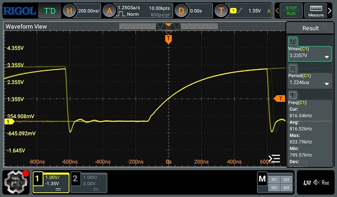

ESP32S3 I2C clock
The S3 data sheet says up to 800KHz.
When I set the I2C clock to 1MHz, and then read the set value, 1MHz will be returned.
// I2C bus clock for MLX90640
// Note: ESP32S3 supports up to 800 MHz
Wire.setClock(1000000); // 400 KHz (Sm) or 1 MHz (Fm+)
// Serial.println(Wire.getClock()); // 1000000
However, I actually measured it with an oscilloscope and found it to be 800KHz.
I'd add this post as it might be useful to someone.
