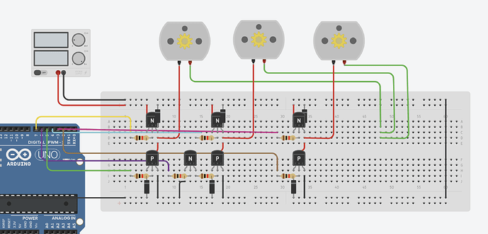

Why is my circuit not working?
I am not sure why my circuit isn't working. Any help would be appreciated and if I left anything out please let me know.

Both n transistors have no base resistor. Take 220 ohm.
Does N stand for NPN or for PNP?
I suggest uou rewire your breadboard with plus on top and gnd on bottom...
Also add a schemayic (pen paper picture is fine).
Why is your motor controlled with a high side and a low side switch?
What is the type number of your transistors?
Are they still alive? The missing bas resistors might have killed them...
I'm not sure what your circuit is. Lotta transistors there for running a motor.
Can you post a link to the circuit you think that is?
Can you draw a real schematic diagram and list the part numbers and component values?

  1. You have not defined the part number for the transistors.
  2. You need resistors in the base circuits of the transistors. Transistor base to emitter voltage max's out as about 0.7V Your Arduino will not be able to force it to 5v so one or the other will loose.
  3. You should attempt to keep your breadboard wires short. These solderless breadboards are not good with high currents.
  4. Please state the goal / desired function.
  5. What is the external power supply supplying? 5V or 12V or ??
  6. How is the Arduino being powered?

Your Fritzy tells us nothing about the transistor part numbers or characteristics.

Hey everyone, thanks for all the responses. I know this is a really weird circuit but it is meant to be part of a bigger one shown below. I am trying to design a 3-phase h bridge to control a bldc motor I am making.
  • I want to use 12V to run the motor. I am using 3 dc motors in this diagram to simulate the coils.
  • In terms of parts, I am using TinkerCad right now to design it so the transistor types don't go further than NPN and PNP and the resistor is just a resistor with no specific value. In the diagram I show, N is NPN and P is PNP. When I actually physically build out the circuit I am planning on using a 2N2222 as the NPN and a 2N3906 as the PNP.
  • I'm using the NPN connected to the PNP to trigger it since my 5V on the Arduino is too low compared to the 12V.
The circuit I originally posted is just to simulate one phase. I feel that if I can get that working, I can get the circuit below working. But please let me know if I'm wrong. Also, if anyone has an idea of how I can change my h bridge below please let me know.

On your second point, would there be a way to trigger the transistor with my arduino? Or is it too weak?
Maybe, without know what the transistor PN is, its hard to tell.
Questions:
  1. Does the BLDC motor have hall sensors to time the commutation?
  2. Have you considered MosFet's instead of transistors?
  3. There are working half bridges with all sorts of good capability. Like no shoot thru, thermal limiting, current limiting etc.

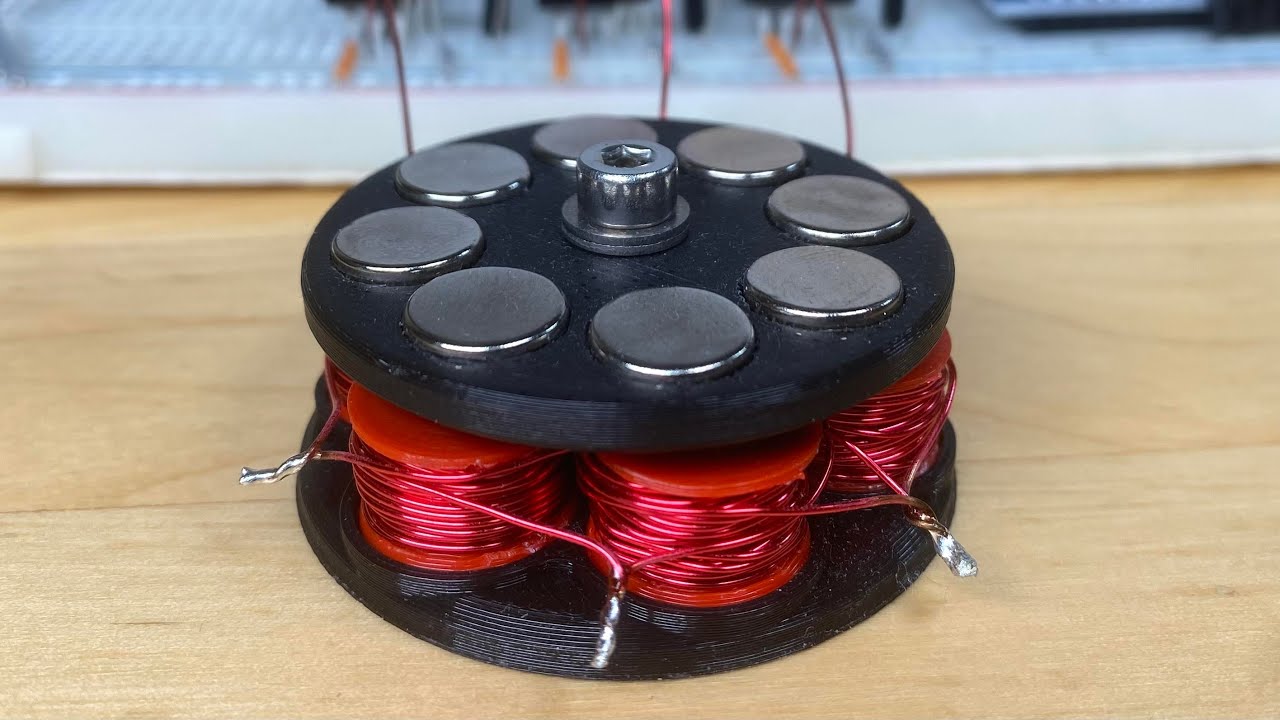

My goal is to do something similar to what this guy did:
He seems to be using mosfets, which I understand I might have to use. But I don't believe he used a hall sensor and just timed the PMW signals through the coils.
That's what "brushless - sensorless" is.
The timing for switching to the next sequence is determined by measuring the unenergized phase.
See "ESC" in any RC forum.
The other question is. What will you use for magnets? Perhaps you can get away with multiple magnets glued together.

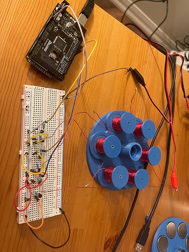

Hi Everyone, I have made some changes since my last post. I have changed my circuit and built it out but it is not working. From my power supply, I can see that current is flowing but the coils do not seem to be magnatized. The coils are 24 gauge wire with 200 turns. The transistors used are:
For NPN - 2N2222A
For PNP - 2N3906
I am using the NPN transistor to activate the PNP for low side swithcing since I am trying to run the motor at 12V and the arduino wouldn't be powerful enough to activate the PNP itself. As shown in the diagram, I have coil pairs wired in series and then the pairs themselves connected to the circuit in parallel.
Attached is the circuit diagram, a photo of the current set up and the code. Please let me know your thoughts and if I should provide any more information.

Hi Tom, I have attached some more information including a schematic. I am using bjts since I have them on hand but if this doesn't work, maybe I'll be forced to switch. Thanks for your help!
