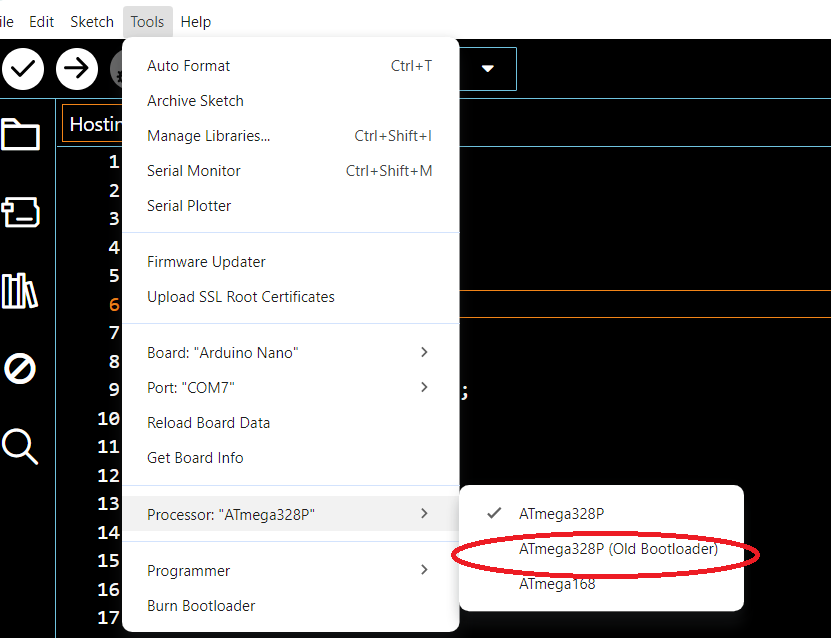

Why is the "L" LED keep blinking on my Arduino Nano?
I’m using a clone Arduino Nano with the CH340 USB-to-serial chip. It was working perfectly yesterday, but today I can’t upload any code to it. The onboard "L" LED (connected to pin 13) keeps blinking steadily, and every upload attempt gives me this error:
avrdude: stk500_getsync() attempt 1 of 10: not in sync: resp=0x85
Here’s what I’ve tried so far:
  • Swapping USB cables
  • Trying different USB ports
  • Restarting the Arduino IDE and my PC
  • Re-selecting the correct board and COM port in the IDE
The Nano is still detected and appears in the port list, but uploads always fail with the same error.
Does this mean the bootloader might be corrupted? Or is there anything else I can try to bring it back to life?
Thanks for any suggestions!
One common cause is that you selected the wrong option under tools → processor.

Select "old bootloader" option under tools/ processor
