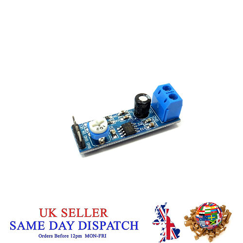

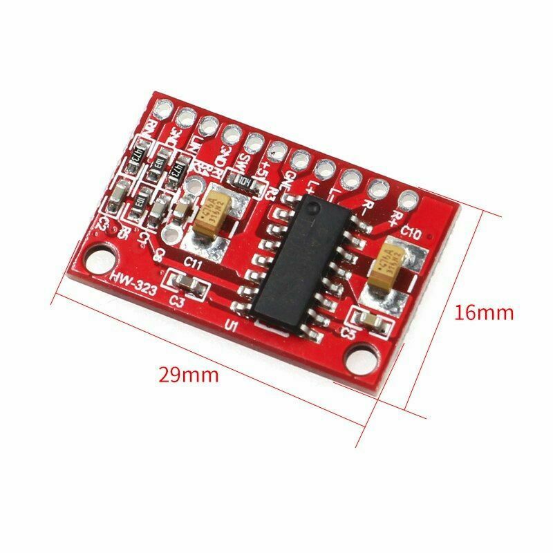

Maybe you could use a small audio amplifier board like those available on eBay etc?
Yeah ı use dc energy from arduino. How to do it. How have to use ac volt?
Amplifier board
Which amplifier. Do you know its name? Does it matter which amplifier ı use?
