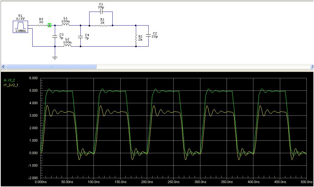

Often problems occur with SD modules and shields that use resistor voltage dividers.
I did a circuit simulation of a divider using 1K/2K resistors where the SD card plus stray capacitance is 20 pf.
The simulator is here http://www.partsim.com/. It is free and easy to use.
I have attached the results. Note how the 8 MHz clock is distorted by the divider and capacitance.
The above simulation is a best case. I used low value resistors, 1 K and 2 K, and low stray capacitance. The SD card has about 10 pf input capacitance so I only allowed 10 pf stray capacitance.
Still the signal does not meet the requirement of less than 10 ns rise time. Many new cards prefer 3ns rise time since they are designed for high speed, 50 MHz, max signals.
I did another simulation using values recommended by a number of users, 1.8K and 3.3K resistors. I also assumed a bit more stray capacitance, 30 pf total with 20 pf stray and 10 pf SD input capacitance.
Here is a link to such a setup https://forum.allaboutcircuits.com/showthread.php?t=27913
The attached simulation result shows how bad resistor dividers can be. The blue trace is 5 V output from the Arduino and the black is what the SD card sees.

Here’s an analysis using what we called, back in the day, a ‘speedup’ cap across the input 1K resistor.

Added output “impedance” 30ohm @1.66mA, 10ns rising/falling edges (of the output signal) and 4in long flying wires (for example) with stray cap. Yea, the old freq compensation of the divider works :slight_smile:
I am well aware of compensated attenuators. But it is not a good solution for this problem for a number of reasons.
You can't determine what the stray capacitance is so you can't pick a value for the cap. You can't even check that you have it right with a scope since the scope probe has a capacitance of 10 - 20 pf for typical scopes that hobbyists have.
You may not be able to easily get the value cap you need if you knew what you needed.
The input capacitance of SD cards vary. and the stray capacitance for any setup with jumper wires will vary.
Level shifters are required on three line, chip select, SCK, and MOSI. It's bad enough to use six resistors but now you need to add three caps.
It is so simple and cheap to just use a buffer like a SN74AHC125N which costs $0.45 at DigiKey http://www.digikey.com/product-detail/en/SN74AHC125N/296-4531-5-ND/375724
Edit: I pointed out in an earlier post that you could use a cap like this on a resistor divider and included a link to a YouTube video on compensated attenuators http://forum.arduino.cc/index.php?topic=216684.msg1606457#msg1606457.

@fat16lib: See the schematics with your measurement setup below. It will work. You do not need $xxxx probe for it. Just try it…
  1. Simply solder the 2k resistor at the central wire of the coax (you must not cut your o’scope probe, do use a freshly cut 100cm long piece of 50ohm coax instead :slight_smile: ). Use as short as possible lengths of the resistor’s and gnd’s wires at the probe side.
  2. Mount an 50ohm BNC connector at the other side of the coax, and,
  3. You will get quality probe (~1GHz BW) for high speed measurements (high speed, large BW measurements are always made low impedance).
  4. Mind you have to switch your o’scope to 10mV/div (or something like that) in order to see the sdcard’s 3.3V input signal full screen (because of aprox. 40x attenuation of the probe setup ).
  5. Also, do not forget 50ohm BNC terminator at the o’scope connector (or, when available with your o’scope, switch o’scope’s input to 50ohm impedance). It will not work when your o’scope input impedance will stay unterminated (unterminated means 1M||20pF input impedance - the standard setup). It must be terminated 50ohm hard (AC/DC path).
Try and see…
Note:
  1. The C2 below is the stray capacitance of the sdcard’s socket and sdcard’s chip input as estimated by you.
  2. The C1 is an experimental divider’s compensation as suggested above.
  3. C1 and C2 is not related to the “probe” setup itself.
  4. The “probe” below does not require freq compensation within a reasonable BW range (<1GHz).
  5. The “parallel parasitic capacitance” of a junk box 0.25W small sized “probe tip resistor” is estimated <0.5pF…
