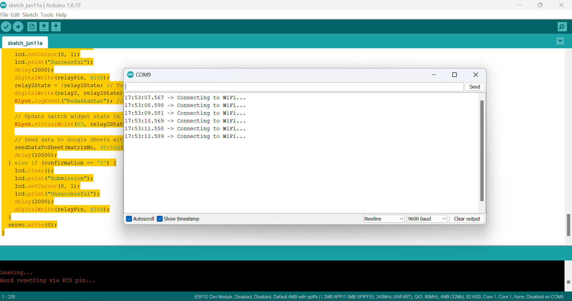

Wifi connection problem
it seems that the wifi is not connecting.Can anybody help

are you using the correct SSID and password to connect? What board are you using?
Have you tried including the WiFi.h library?
im using esp32 and yes the ssid is correct.Ive tried using wifi.h but still the same
Maybe try comment that line out?
try running File>Examples>WiFi>WiFiScan
does you target SSID appear?
Make sure your wifi is 2.4Ghz.
blynk did not initialize after removing that
