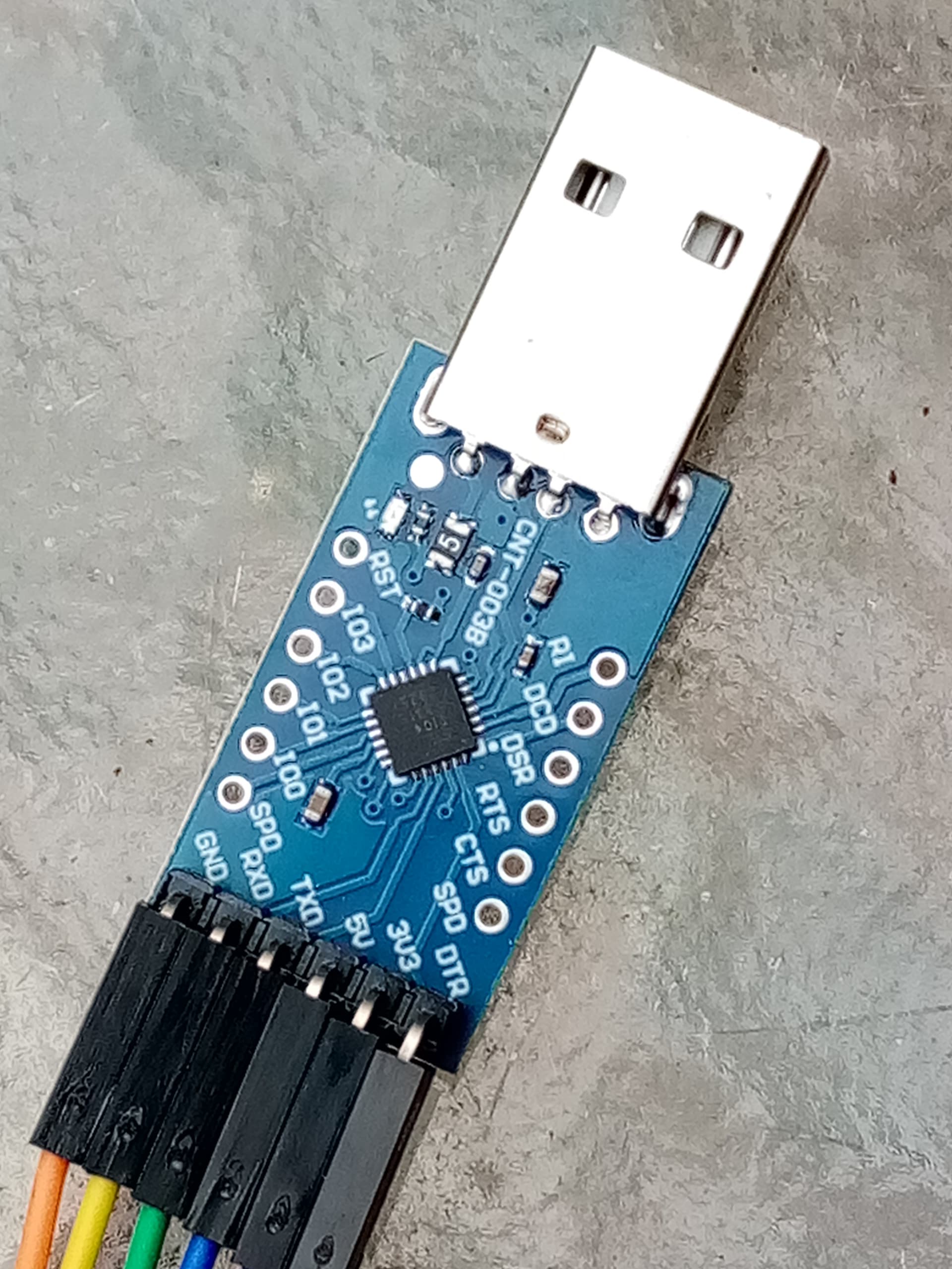

I'm drawing a blank with programming the ATTiny85. Nothing seems to be working. I'm prepared to believe that large quantities of stuff from China is either a scam, broken or just won't work. So far the "kickstarter" ATTiny85 board seems to fall into that category. Also the "HW-260" programming board. The latter came from eBay together with the ATTiny85 chips. I have no proof that the ATTiny85 chips are genuine either. They could be 555s with the logos changed. Who knows with these online suppliers?
I've just received this from Aliexpress. It's alleged to program the ATTiny85 but comes with zero instructions which is mighty helpful.
I also found this in my collection of bits. It looks like somekind of programmer but what for, I'm not sure. It was probably one of those things that looked useful that just pushed the total over into the free postage level. I have no idea if this could be used on a Tiny85. Again,no damn instructions.

The picture is a USB to serial converter. Look at the labels on the pins.

Hmm. I just plugged the alleged Atmel STK500 in. It came up as
Bus 001 Device 004: ID 1a86:7523 QinHeng Electronics HL-340 USB-Serial adapter

If you are referring to the plastic box with the ribbon cable in your post #1, then it looks like a copy of an Atmel AVR ISP (Mk2?). Providing it works, then it should be able to program a Tiny85.
I've just checked my genuine AVR ISP Mk2 and it has a 6-way ribbon cable coming out of it. Yours looks like a 10-way ribbon cable. I think that there is a small dongle you can buy that will convert 10-way connector into 6-way. However, if you need to make yourself a small board to hold the Tiny85 whilst programming it, then you could fit a 10-way header.
As far as I know, an STK500 is a development board and looks something like this:

That's not necessarily a bad thing. The original STK500 connected to the host computer via an rs232 port; it makes sense to replace that with a USB/Serial converter in more "modern" implementations. All you need is a proper Serial device drive for the chip (looks like a CH340 "equivalent"), and to tell avrdude the COM port that should appear.
