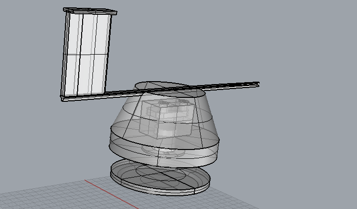

Has any of you tried fitting a compass sensor inside a wind vane? In this case the problem it's not more electronic i guess, its more mechanical,
I am planning to use a MPU 9250, so i can get tilt compensation.
The idea is to fit the sensor inside the wind vane body, something like this:
the white block represents the 9250 unit (sorry for the quality it's just a sketch).
My only issue now it's how I keep the cables from spinning, but I would try using a Slip Ring conector like this one :
Any ideas for mechanism , bearings? or tell me if it's just a crazy idea, everything is welcome.

It sounds like a nice idea.
Depending on the resolution you need, it may be a bit overkill though. Have you considered more low tech solutions such as optical sensors?
[edit] On this page they explain how you can detect 16 different positions using four optical sensors.
The nice thing is that you can make this almost friction free.

Bear in mind that the wind changes slight direction second by second ( look at wind vane moving about ) so it may be pointless trying to get very accurate readings , certainly correcting for magnetic north is a bit over the top .
The usual method is 8 Reed switches and a magnet on the vane. Simple and reliable ( important when it’s out in all weather)
Worth experimenting before you build, need to think how accurately do you need to measure , rather than what’s possible .

If you need that , I would use an optical encoder - slip rings etc aren’t great in wet environments

A windvane's axis is meant to point into the wind, not North, that doesn't make it's reading wrong.
I'm not trying to be difficult here, I am interested in windvanes. I also have one of those windvanes with resistances and reed switches inside, and I have imagined other ways that they could be designed. So I'd like to understand your design, but right now I don't get it.
If this was a portable windvane, I could see the benefit of using a tilt compensated compass inside. The user would not have to orient the windvane to North, or find a perfectly level surface to place it on for each use.
But for a permanently installed windvane, you would calibrate it for north and check that it was level during installation.
One design that would remove the need for reed switches and resistors would be to mount a bar magnet in the rotating part of the windvane and mount a magnetometer in the static part. The magnetometer could then be used to detect the orientation of the magnet. No slip ring would be needed.
I would not expect the wind vane to report anything but apparent wind direction relative to the boat. Any translation to true wind readings would be done elsewhere using data from the primary compass, at least on any racing setup i have used.
