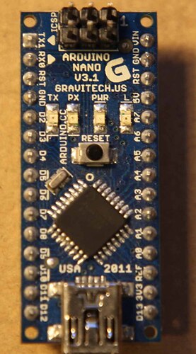

Time to post decent pics of both sides of the board.
Note the forum has a max size to you may have to crop and reduce the resolution if it spits an error.

Thanks for your continued interest. I'm afraid I wasn't clear in my goal: I want my "real" Nanos to be recognized. I have recycled the Chinese versions.
I have also cleansed my Windows 10 of all CH341*.* files and folders:
Clean up steps:
  1. Delete the downloaded device driver installation file.
  2. Searched the C:\ drive for 341.* files.
  3. Deleted C:\WCHN.CN directory and subdirectories (these are installation folders).
  4. Deleted C:\Windows\System32 files\CH341PT.DLL and CH341SER.VXD .
  5. Deleted C:\Windows\System32 files\CH341SER.SYS and CH341S98.DLL.
  6. Deleted C:\Windows\System32 files\DriverStore\FileRepository\ch341ser.inf* folders (the subdirectories contain *.SYS, *.INF, and *.CAT files).
Note that #6 required changing FileRepository permissions to overcome SYSTEM and allow me to delete the driver directories. There are several warnings about doing so.
After all this, Windows 10 and the Arduino IDE still don't play with the "real" Nanos. Device Manager recognizes there is an FTDI device at a given COM port but, unlike my other Arduino boards, it no longer recognizes it as a Nano. The IDE hangs on uploading sketches, coming back with a message that there has been a problem uploading and go to troubleshooting.

Bob,
I've been offline for Christmas traveling. Thanks for the clean up tips. I can now communicate with genuine Nanos. I still don't see the Nano labeled in Device Manager's COM port like the UNO and Mega but I'll be content with the very significant progress.
BTW, I did upload front and back pics in my Dec. 17 post.

Ok so it is 100% an FTDI based board.
Missed the pics...My bad.
