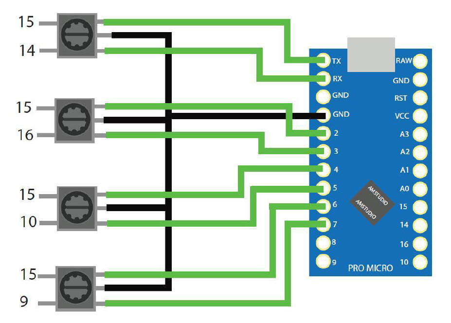

I am building a button box for sim racing. I purchased the plans from AMStudio but want to make some modifications.
I want to change one of the momentary push buttons to a latching toggle switch. I also would like to wire in an LED to indicate whether the toggle switch is on or off. The code part of it I have sorted out. Now I am just trying to figure out if I can wire in an LED in the current matrix setup.
The pictures below show the wiring of the buttons and encoders. For clarification, I will exchange the top left push button for a latching toggle switch. I will also add diodes after each switch to avoid ghosting.
The toggle switch I have is a SPST switch. I know 1 solution would be to get a DPST switch and wire the LED to 5V and ground with a current limiting resistor in the circuit.
My question to you guys is, if I can wire in an LED with the current SPST switch I have.
Thanks!

Perhaps I need to clarify; this button box will be connected to a computer and will act like a joystick/keyboard. I will then map the buttons to a function in game. For example, I will map the top left button in the matrix to the ignition. At the same time, I would like it to turn on an LED indicating ignition is on. Basically like the fan switch in the picture. Flip up the switch, LED turns on. I just don't know if the Arduino micro has enough pins left to control an LED or if I can wire in the LED in the current matrix or if I need to do anything else.
No, I got what you are saying. You can use a simple LED driver IC to control the LEDs with the Arduino and just a few pins and the keypad with a few more pins.
It will do exactly what you want without any real issue.
Check out projects that use Arduino and a MAX7219.
You can use it many ways and it will run up to 64 LEDs with only a few pins.

@er_name_not_found Will look that up for sure. I guess I am not sure if I have enough pins left on the Arduino to control the LED driver?
@Paul_B, yes, for sure. I am planning on putting in a diode after every button.
You have a keypad and an LED matrix, as well as a serial connection to the computer, what else are you adding to your project that's eating your pins?
@er_name_not_found, basically the button matrix uses all pins on the arduino except for 2 ground pins, raw, reset and VCC.
Do you have a link for the encoders you want to use? I think you may have a different issue
Use a TM1637/TM1638 to drive all the LEDs and read all the switches. It uses only two I/O pins.
@er_name_not_found I have these; DaFuRui (7 Pin 20MM)10 PCS 360 Degree EC11 Rotary Encoder Code Switch Digital Potentiometer with Caps Amazon.com
