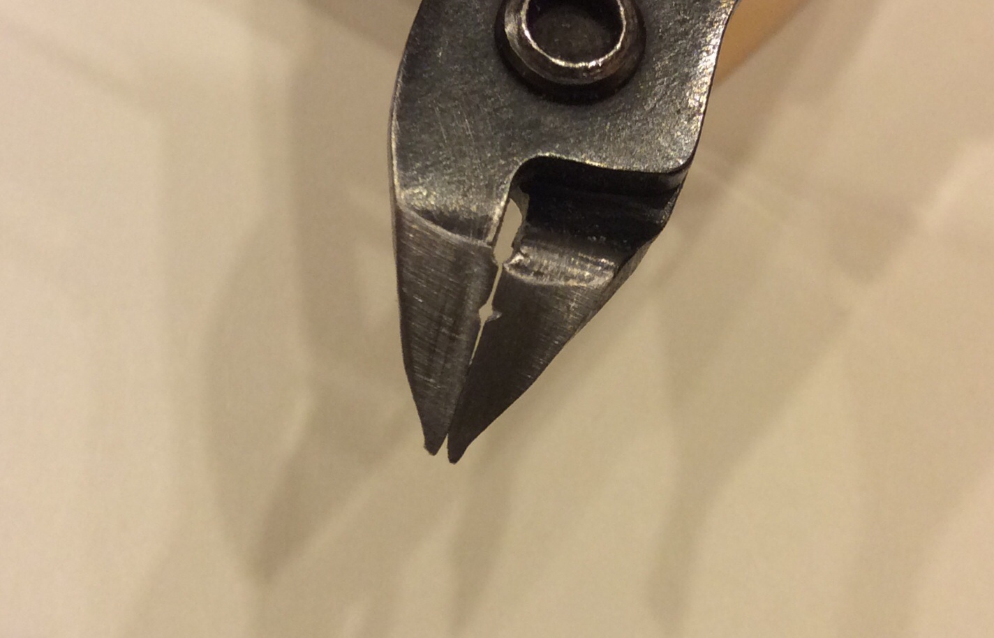

I need to make a lot of wires that will be 18ga and I need to crimp fork terminals.
I typically use a wire cutter/stripper that looks like sizzors with some holes ground out allow teh insulation to be cut, but not the copper.
someone said I should get some wire strippers that grab the wire and strip off the end in one squeeze.
suggestions ?

I don't actually use wire strippers. I prefer using side cutters. After 45 yrs of practice, I manage not to knick too many!
The trick to using side cutters (for new players) is to use them the right way around. Good electronic cutters have a flat back for close cutting and the other side tapers. If you use them so that the waste is against the flat side, the blade digs in and cuts through the insulation. Using the other way around, the insulation is being pulled through a funnel and the blade will not grip the insulation.
Mechanical strippers however would probably be better for lots of wires.

As weedpharma said.
I made my own:
LarryD:
As weedpharma said.
I made my own:
The last time I ended up with cutters that looked like that, it was because I tried to do something stupid (cut a spring). Got a new pair.
Cutting a spring would be a great way of making your own stripper.
I used a small diameter Dremel diamond bit.
I find a set of cutters with a slot to be a PITA. I have calibrated my grip so that I use normal cutters to strip wire.
It would not be allowed in critical circuitry but it works for me.
