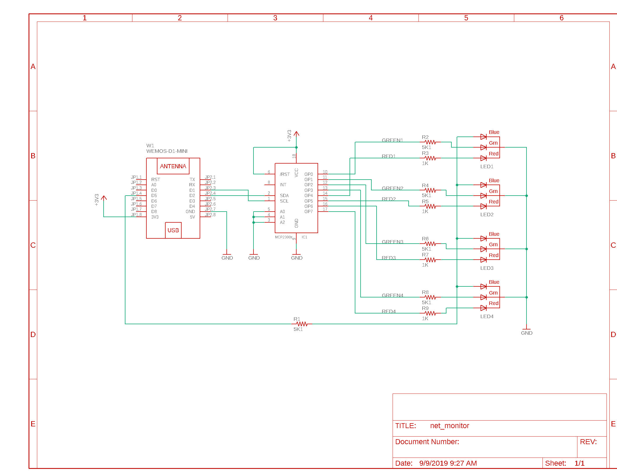

Wemos D1 Mini ---> MCP23008 IO Port Expander
If you need 16 ports, use the MC230017.
Done.
Here is a schematic of a project I did last year using the Wemos D1 Mini and an MCP23008 port expander. The project was to be able to tell at a glance if everything on my home IOT network was running. The Wemos pings my NAS, Home Assistant, PLEX and router every ten seconds. If a ping fails, the LED goes red.
