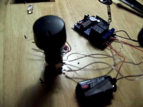

Wireless RF relay controller to power 2 motorized potentiometer to Arduino:
So im using a potentiometer with my Arduino to move a servo that is hooked to my cam. It all works well but the Arduino has lots of wires coming off of it and im always trying to cut back on the clutter. So now i have this Wireless RF controller hooked to a motorized potentiometer so that i can pan my cams Wire free. Here is a link to a video showing how the relay and motorized potentiometer are set up. You will also see that i had to use 2 batteries to get the potentiometer to move one way then the other. I would like to try to get that down to one battery. I tried every which way and just could not make it work. Seems like an ez fix but its not. If any of you come up with anything, a diagram would be nice.

For the motor control - look around for h-bridge dc motor:
http://www.google.bg/search?q=site%3Aarduino.cc+h-bridge+dc+motor&ie=utf-8&oe=utf-8&aq=t&rls=org.mozilla:en-US:official&client=firefox-a
It's pretty simple to hook it up directly to the arduino. Then you'll need to change your schematics a bit - the signal coming from the RF module should be fed into a digital arduino pin (resistor in series required!!!) and when sensing the pin being pulled up you start controlling the h-bridge.
You might be better off using the device you are pointing at in your other topic:
http://www.arduino.cc/cgi-bin/yabb2/YaBB.pl?num=1245825338/0#0
