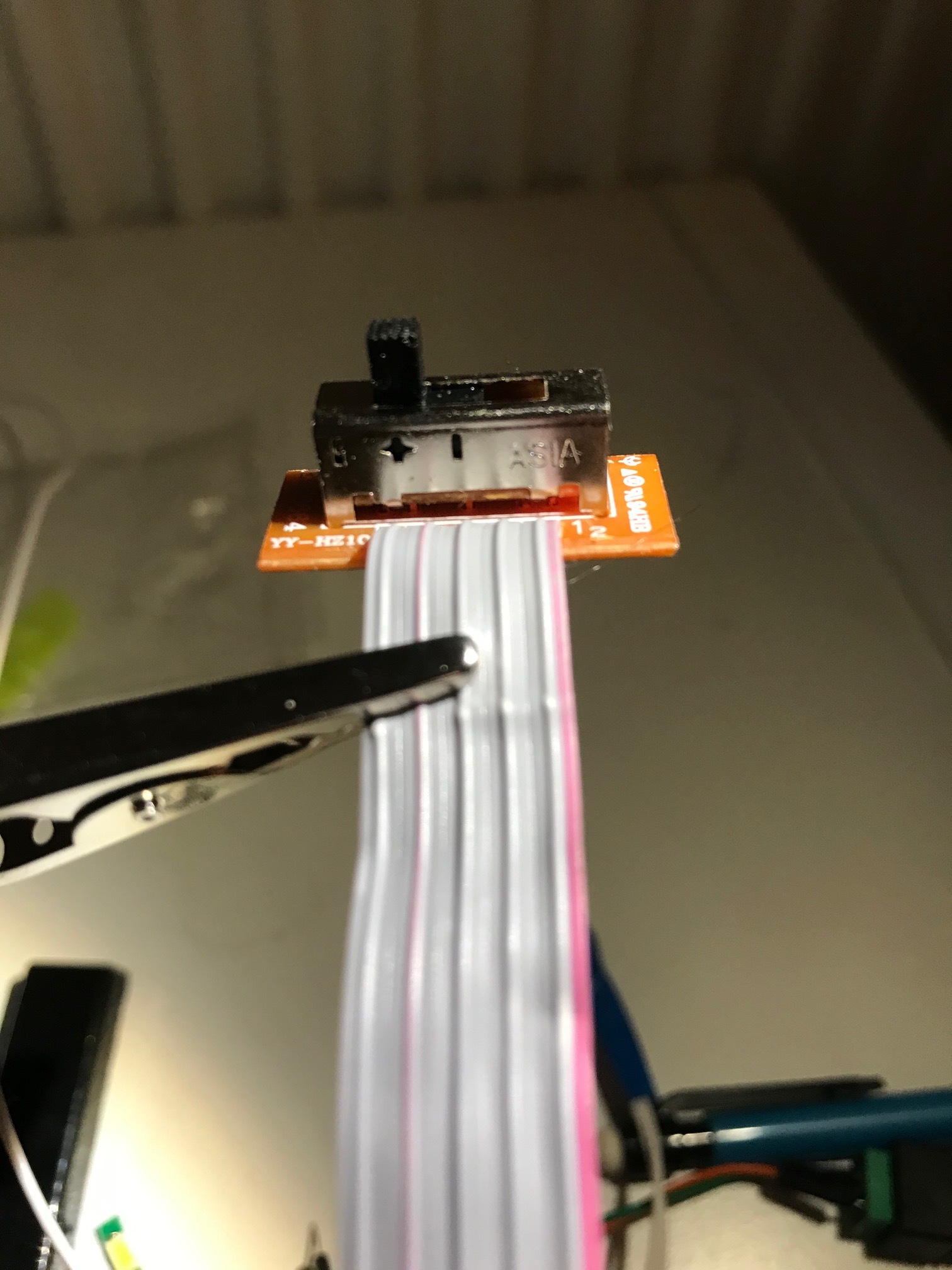

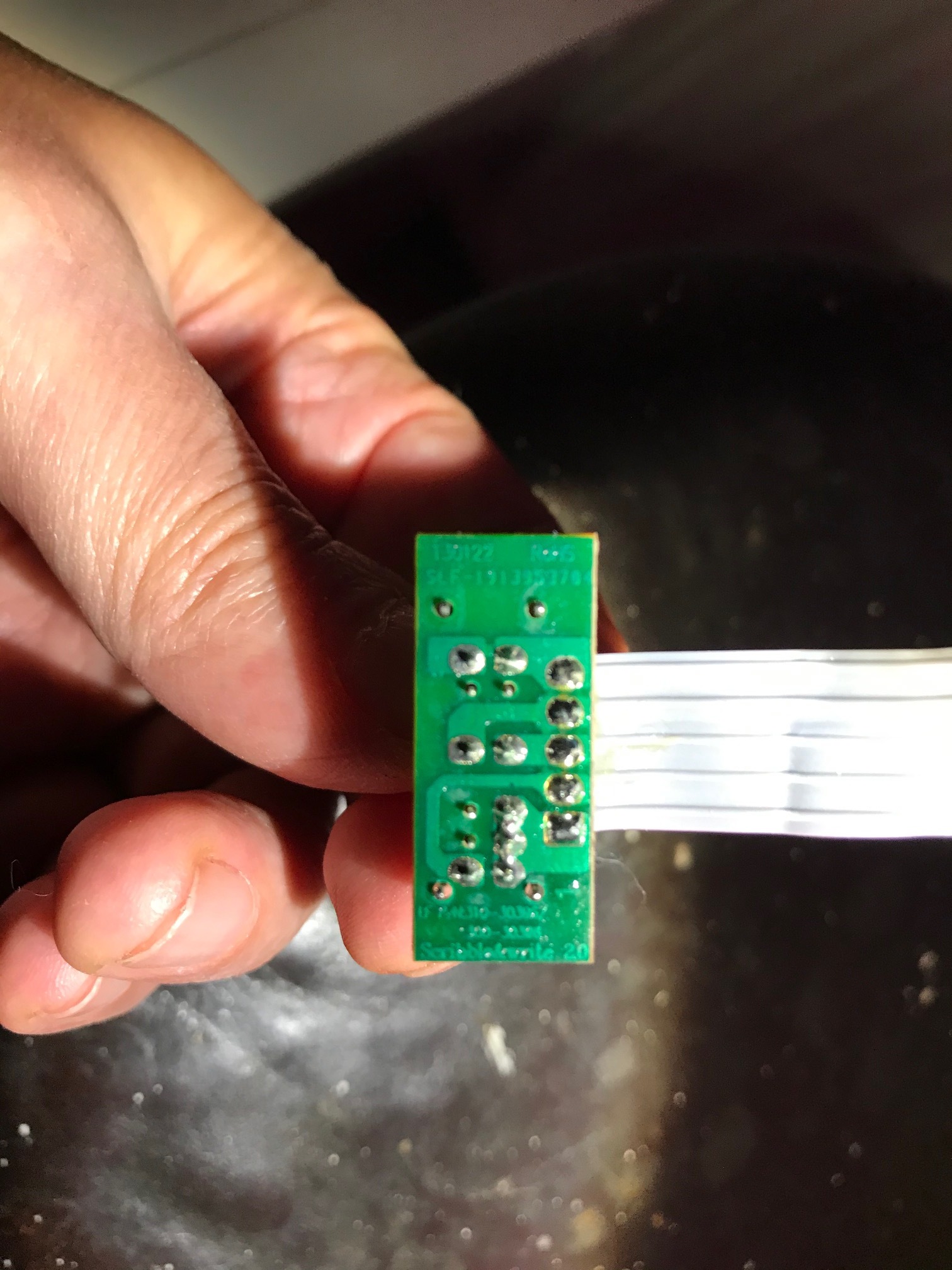

I wanted a switch with three positions - off and two other modes. Found this on ebay:
Picture of back is attached.
Just need to know which wire goes to 5V which to ground and which are data pins.

I see 12pins and coming out of the base of that switch?
Is there a number on the side of the switch?

You see which pins are connected to which but only way to be sure is a continuity Truth Table showing
continuity from which pins to which for the three
positions.
Here's a side view.
Yes the switch has three positions.
In left position there's continuity between 1 and 3.
In centre position there's continuity between 3 and 5.
In right position there's continuity between both 3 and 5 and 2 and 4.
What I'm trying to do is extremely basic:
In right position send message to one LED pin.
In centre position send message to a different LED pin.
In left position send to neither.
Hope this clarifies things a bit.

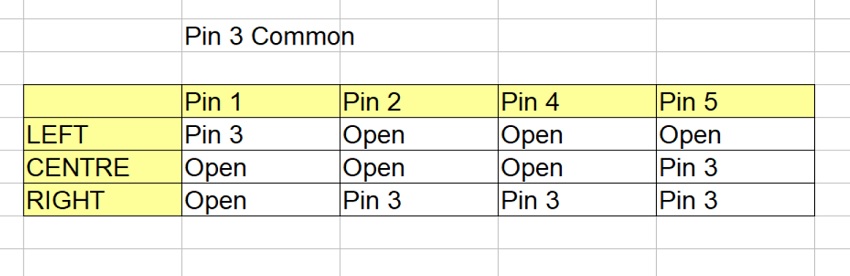

Thanks for the info, this truth table should show you how to code for your 3 positions;
Tom.... :slight_smile:
Thus, connect Pin 3 to ground, and Pin1 and Pin2 to digital inputs with pull ups enabled.
So it is of course, not a "one pole" switch.
Both Tom and aarg have got it wrong. :roll_eyes: As per #25, pins 2 and 4 are one pole, pins 1, 3 and 5 are the other as the PCB illustrates.
If you ground 2 and 3, then pin 4 will tell you the "right" position and pin 1 will tell you the "left" position. You cannot with this PCB, have "neither" at one end, it must be in the middle.
There are however, pins on the switch unused on this particular PCB. :astonished:
The truth table was generated purely on the OPs posted info.
It will provide the function he needs.
Unless
Means 3 and 5 connected, and separately 2 and 4 connected.
Not all 4 connected together.
Tom... :slight_smile:
