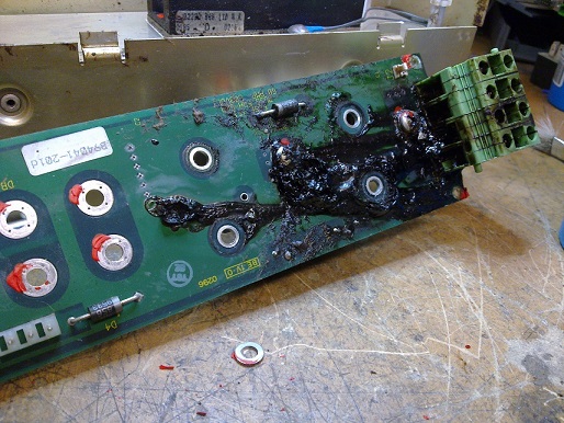

I used to work with Siemens programmable controllers for building automation (Siemens PRV units from the 1980's for those wondering).
Whenever there was a blackout or a lightning strike in the area the following week the caps inside some units would either leak or blow up. If we where lucky we caught it fast before it corroded the entire PCB and there was nothing left but molten plastic containers...
But i'm getting off topic here!
