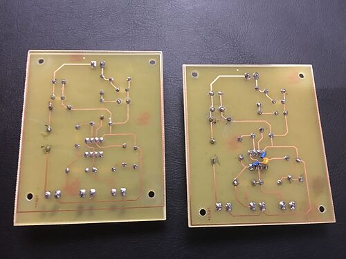

The problem with the actual circuit is that as soon as I power it with 12 V the second diode (BZT) breaks.
The BZT03C36 has a zener voltage of 34 to 38 Volts. So if it breaks then the zener is broken or you do not have a BZT03C36 in the first place. To my eye that diode looks like a small signal diode and not the shape the data sheet suggests it is.
Hum, I think I know my mistake!
I chose a wrong zener 3.3V instead of the 36V :zipper_mouth_face:
So it obviously not surprising that the diode breaks. I feel stupid to don't have a check before.

I use I/O 1 on the LMI 393.
With Vbat = 12.05 V and Vlm393 = 4.89 V I get:
V1 = 11.36
V2 = 1.68 V
V3 = 1.18 V
Thank you in advance,
Pm
V1 here tells me if its 3.3V zener then its cooked and open circuit.
Tom.... :slight_smile:

Finally, I did 2 circuits (front and rear wheels), one with the recommended modifications and the other like it was when I wrote the first post. We will be able to see the difference with the results.
