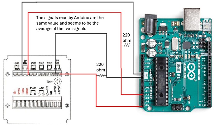

I have a pH controller that can output two 4-20mA signals. One for pH, and one for temperature. The outputs on the controller have a + and -
I've wired a single output with a 220ohm resistor between the positive and negative with the positive going to analog pin 0 and the negative going to gnd on the Arduino. This gives me a 0.88 to 4.4V signal to the Arduino. There are no issues here. The pH controller also displays the output signal and it matches what the Arduino reads.
The issue becomes when I wire up the second 4-20mA output the same way I did the first (but to a separate analog input pin on the Arduino). When I wire this second signal in, the Arduino reads the same signal for both pins. I have a feeling I did something wrong on the wiring side of things. Can anyone please provide some advice/assistance?

The wiring looks OK, so the problem may be in the code. Post that, using code tags.
Wrong, but not what you did. Your device did not ISOLATE the two 4-20mA signals, so there is a single power supply for both.

You could use a multimeter continuity check setting to determine whether the negative terminals of the 4-20 mA outputs are internally connected, that is, share a common ground. In such a case there should be no problem with the wiring you originally posted.
There IS a known problem with switching channels on most MCU ADCs, in which one channel reading appears to affect the next channel reading. People solve that by discarding the first ADC reading after changing channels.

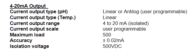

Actually your manual says the two signals are ISOLATED, up to 500 volts, so that is not the problem.

I'm not sure they will be isolated from each other,
so a continuity check between the GNDs would be useful, just to eliminate that posibility.
Also you should protect the arduino with a series resistor (say 20k) to each analog input, and a small capacitor (say 10nF) to reduce noise.
as @TomGeorge says, you need a dummy read of the ADC before taking a valid reading, and I'd also be inclined to add a digital filter as explained here - your temperature and pH readings are unlikely to change very rapidly.
I've connected a multimeter to each analog out negative line and got a 204 ohm reading. It changed when I checked again in 2 hours from turning the unit on to 145 ohm. I guess these signals are not isolated from each other then.

Going through the calibration settings does nothing to the output of the controller. The screen of this controller displays the output signals for both temp and pressure - which are different values and match perfectly to the converted voltage signal I read on the Arduino when either ONE is connected:
Controller Display:
pH mA out: 8.29mA
Temp mA out: 7.38mA
Arduino output with the posted code when ONLY pH signal is connected:
T, (floating value),
P, 1.82,
Arduino output with the posted code when ONLY temperature signal is connected:
T, 1.61,
P, (floating value),
When BOTH signals are connected to different analog inputs on the Arduino, both inputs read the average of the two signals:
T, 1.71,
P, 1.71,
These results are the same with and without a "dummy" reading.
Then that tells us the manual is wrong. That happens because the writer of the manual was writing what they though they heard from the engineers, not what they, themselves, observed or tested. Thia is not an unknown problem with manuals on anything!

Simplest change, then would be to use a DPDT relay, Double pole, double throw. Normal connected to one signal pair and when your Arduino activated the relay, then the other pair is connected. That way your program always knows which signal is being monitored.
This is a good read: Ground Loops & Non-Isolated Commons | Precision Digital
Do you have 51 Ohm resistors?
