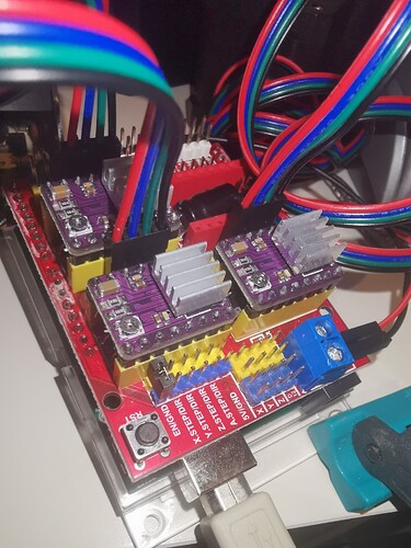

With the CNC shield you cannot control the individual motor enables, though. All 4 stepper driver enable pins are tied to pin 8 on the PCB.
Thanks a lot! what's funny is that I bought specifically some jumpers to add one on the EN/GND pin... And forgot in between.
Now I might have some pin issues, because when I power the arduino on, motor z (it seems) do something, like "tick" noises, but none of them move. I'll have a more careful look at the pinout.

I don't see or know of any reason for that. Hmmmm.
This is not very spectacular, but as soon as I power the arduino on, one can hear one loud continuous motor sound for ~2s, then a 7s silence, then continuous regular tick sounds about one every second or less on MotorZ.
Maybe I damaged drivers for some reason.
Maybe I should test another library like accelstepper to see how it goes?
I have used MobaTools quite a bit with the CNC shield and multiple steppers and never noticed anything like that.

Did I fry the drivers then? Is there a way to test them?

So you hear those noises, but none of the motors move? Is that right? Or is it jit the Z motor that will not move?
Please refresh my memory. You did, properly, set the DRV8825 coil current limits? If so, what value of Vref?
The fastest and surest way to kill a stepper driver is to connect or disconnect the motor from the driver while the motor power is energized. It only takes a millisecond.

Yes correct, none of the motors move. Maybe the Z one move one step per one step while ticking. I can't tell.
Yes I took a value of Vref = 0.95 V (my motor being 2A). I'll check it again once at home, maybe I didn't really pay attention and in fact it was 0.95 mV.
I do not remind doing such a thing. I plugged motors when everything was off, and let them plugged afterward.
I think I did it correctly, is it OK like this?
That is running the driver pretty near their max current spec. I have read that the heat sinks on the DRV8825 drivers are not particularly effective without active (fan) cooling. I would suggest that you drop the current limit to no more than 1.5A unless you use a fan.
It is a good idea to not use more current than is necessary to get good performance with no missing steps. The motors and drivers will run cooler and live longer.
Yes, that is the correct jumper placement to permanently enable the stepper driver outputs.
OK I did this:
Surprisingly, now when I play the code with Moba Tools, not only the Z motor ticks, but so do the 2 others...
Is there any chance that it could end up working by fine tuning Vref?
I honestly cannot say. It is a surprise that what you did mdkes that sort of difference.
