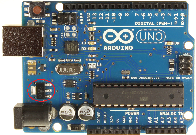

This is the area the board is getting heated (Circled).
Using 12V to the power jack, and requiring more than a little current from the 5V, that could heat up the voltage regulator. That voltage regulator is next to the power jack.

Can you tell me the marking on the original UNO's voltage regulator? It is a small black rectangle with one wide tab on one wide side and 3 pins on the other wide side. Here is a picture what it is. I've circled it for you.
