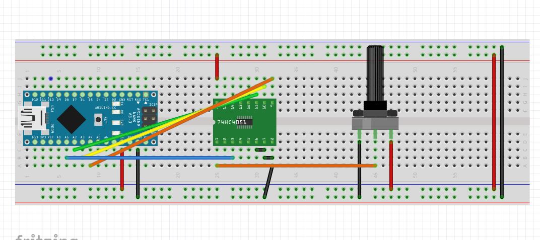

Hello,
I am working with the 4051 analog expander IC. I made all my connections but i got one problem. Each time i move the circuits on the table or turn off the circuit then on, the value of the potentiometer at 0 angle is different. The value is never 0 there is always a number. So remap it with map() to get 0-255 range but each time it changes i have to remap it again manually.
for example I plug the arduino in my laptop and check the start value let's say it is 150, then I unplug the arduino then plug and the value is 200. but when I plug and turn the pot everything works fine and i get a value on the display.
So what I am looking for is to let this be done automatically in the sketch by defining the value at 0 pot angle at the start to be the minimum value and the max reached to be the maximum value. It is to note that i am not turning the potentiometer all the way because it is my application that i should not turn it all the way. So I need your help make this work please.
In my sketch below, I tried a method, but seems not working and I thought also of making an array in which I add the values from the pot to it then should the minimum and maximum
It is to note that values of analog pin is never 0 with the 4051, I changed many and all worked this way thinking that i have a defected IC.
I am using a potentiometer like this
here is is my sketch :

I have a couple of thoughts...
  1. You didn't mention the values you are seeing only that they are not stable. It would help to know the actual data.
  2. You should test your arduino with the A/D input that is going to the 4051 by shorting it to ground. The nearest ground on the board. See if it is stable.
  3. Its been a long time since I worked with the A/D inputs, however I don't thing it will ever reach 0. I may be wrong here.
  4. When you are dealing with analog signals it usually helps to have a resistor - capacitor filter right at the arduino. Perhaps a 5k in series and a 0.1µf to ground.
  5. How is your circuit physically wired? Are there other things going on? Grounding is important here. By grounding I mean which grounds are hooked where.
Is that a walking average ? It is common to fill it with a start value.
  for( int i=0; i<numReadings; i++)
    readings[i] = analogRead( AnalogIn_z);
Which Arduino board do you use ?
Can you show a photo and/or schematic ?
Perhaps the potmeter is not connected properly, or perhaps you use a breadboard ?
An auto-zero is overthinking it, there is a problem somewhere that needs to be fixed.
A potmeter is never zero. A normal way is to use a margin for the maximum and minimum.
Suppose you have an Arduino Uno and the analogRead() returns 0...1023. Then you can reserve 5% on both sides, that is a value of about 50.
0...50 -> 0
51...972 -> 0 ... 255
973...1023 -> 255
When I have to guess, then I think that you have a breadboard with bad contacts.

1- values I am getting when I turn the arduino on without touching the pot are: 447 or 441 it keeps changing between these 2 values up and down
And about my application the picture attached in the original post shows the handle how it is and the pot is not at 0 angle, it has some angle to it. And when I click the handle, the pot turns to reach a value between 560 and 570
but if i turn the arduino off and turn on again the value at start becomes 432 and that keeps changing if i turn off then on each time.
well, I unplugged the arduino from usb and plugged it and kept doing it for many times and here is the results at the start without touching the pot handle:
1st time: 417
2nd time: 427
3rd time: 421
4th time: 425
5th time: 431
6th time: 439
7th time: 441
8th time: 443
4- what do you mean having a resistor at arduino?
5- I attached a picture which shows my circuit in fritzing

1- what do you mean a walking average ? and you mean the array should have a start values like 0?
2- arduino Nano, I posted a fritzing picture showing my circuit
3- I use a breadboard yes for now, it is a testing circuit
4- well, I unplugged the arduino from usb and plugged it and kept doing it for many times and here is the results at the start without touching the pot handle:
1st time: 417
2nd time: 427
3rd time: 421
4th time: 425
5th time: 431
6th time: 439
7th time: 441
8th time: 443
how is that margin done you mean ?
5- I dont think the breadboard mind be the problem because it is a new breadboard and there is a signal always, don't you think ?

thanks again for your help, well let me explain
having a value of 425 is not a problem at start because as i said, the potentiometer is not at 0 angle in my application, it is turned a little so that value is logical. It is the way the handle was designed to have not a 0 value on purpose.
for your solution of samples I think i did that in smooth don't you think ? I took samples and made a smoothing pot but the problem still happens which is each time i turn the arduino off then on a new starting value come up so that is why I am looking to make the starting value dynamic to be able to set the min and max of the map() function
You don't have to quote my whole post, what I wrote is already there :wink:
I'm slowly getting it. I thought that the potmeter was at angle 0.
The potmeter is in a mechanical clutch foot pedal ?
When you start the Arduino, then the clutch is in the begin posistion and the potmeter is almost halfway ?
You need to get the offset in setup().
The running average is here: https://www.arduino.cc/en/Tutorial/BuiltInExamples/Smoothing and in the Arduino IDE menu: File / Examples / 03. Analog / Smoothing
That can benefit when pre-filling the array in setup().
If you don't pre-fill the array, then you can call the smooth() function a number of times.
The next code should result in a percentage from 0...100 for the potmeter. I suggest to make an other sketch to test it.
int potMin = 0;
int potMax = 1023;
  // prefill the array or call smooth a number of times
  // find the value at the begin position and use it later as a offset
  int potMin = smooth( AnalogIn_z);
  int pot = smooth( AnalogIn_z);
  pot = contrain( pot, potMin, potMax);
  int percentage = map( pot, potMin, potMax, 0, 100);
That might not work together with the code in the loop(). I don't understand what code with the 'clutch_current_min', 'clutchAverage', 'clutch_min' and so is doing. Is that some kind of automatic way to find the minimum and maximum value ?
Suppose you press and release the clutch with force, then the begin value of the potmeter changes. So you still need those margins.
  int margin = (potMax - potMin) / 20;  // divide by 20 for 5% margin

A proper schematic will be better.
If you take the pot out of circuit.
Connect the 4051 input that was going to the wiper to gnd, what value do you get?
Connect the 4051 input that was going to the wiper to +5v, what value do you get?
If you take two 4K7 or similar paired values and replace the pot with.
One 4K7 between gnd and the 4051 input.
On 4k7 between 5V and the 4052 input.
This should put 2.5V on the 4051 input.
What reading do you get?
Please measure it with a DMM as well.

thanks for your help I connected the pin number 4 of the 4051 that was connected to my pot to GND and it gave me a value of 193 ! is that normal ?
Pin 1 of the 4051 is Y4, not pin 4....
MarkT:
Proves we need to see a real circuit diagram, reverse engineered from the project.
Can you post a real picture of your project please?

Have you actually measured the voltage at the pot wiper and at the output of the 4051 going to the controller analog input?
This would mean writing some simple code to select the Y4 input continuously.
You possibly have some hardware problem, lets write some code to check it out.
Did you write some code when developing this project to check that you have the addressing and reading correct?
That is to verify your hardware.
Have you measured voltages with a DMM?
