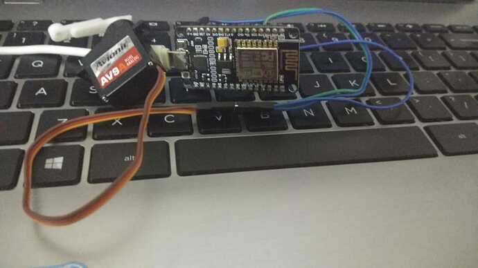

Servo Control with Micropython - with the ESP 8266 ...- compared to Arduino

well - I have a question an an idea.
is 3V3 enough to run this!? The thing that looks interesting to me in this class is the fact,
that in the example for the ESP min is said to be 40 and max to be 115... and I allways thought how can we make 180° out off that (Chapter 7.2) cf 7. Pulse Width Modulation — MicroPython latest documentation
generally spoken - and compared to the Arduino: Then I looked into the source and saw that this used totally differnent values for min and max microseconds 600 and 2400. Well if we compare this to the Arduino reference and they to also took totally different values 1000 to 2000. See: Is it a depending on the servo manufacture that some values are min is 400 µs lower and the max is 400 µs larger.
the question to me: Why are the examples from the mircopython docu totaly different?
Finally i want to add an idea. What about an read method, at least the arduino has got one. :wink:

so the question is just - do we need that library - cannot we just start without that
love to hear from you
