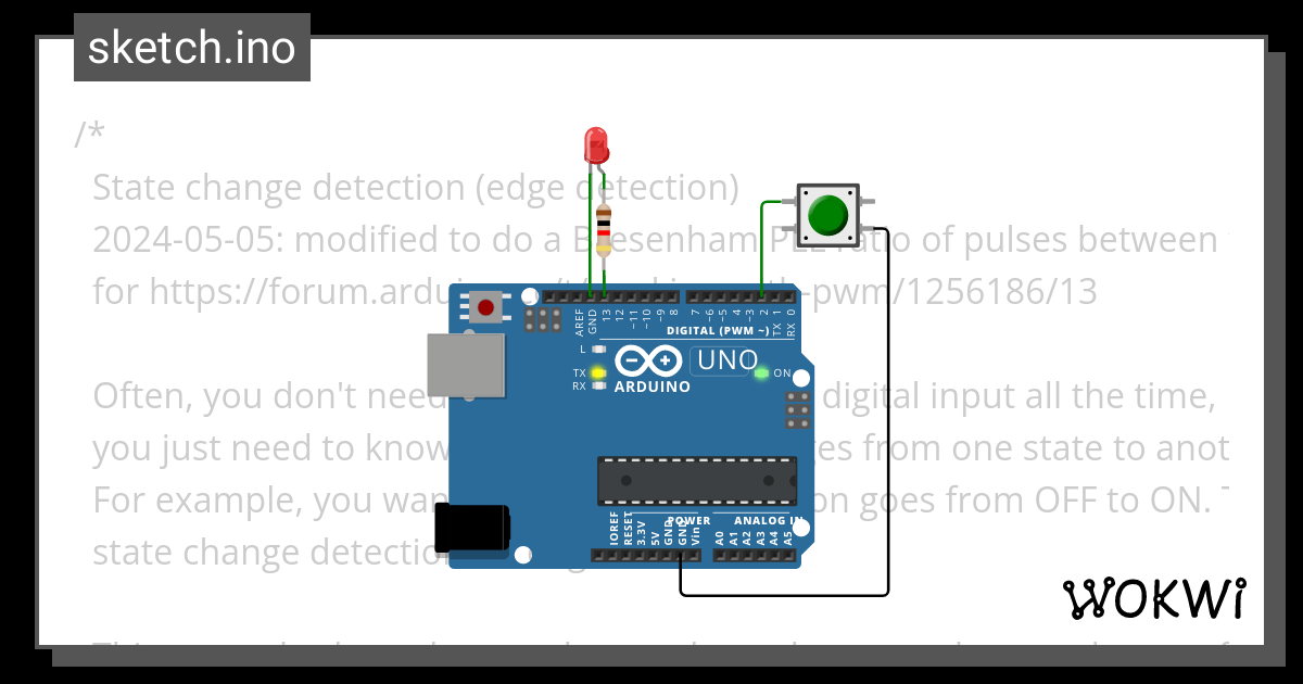

You could build without delays off of the StateChangeDetection example:
https://docs.arduino.cc/built-in-examples/digital/StateChangeDetection/
...with some extra logic to use the Bresenham Algorithm to make the different speed pulses. For example:
  State change detection (edge detection)
  2024-05-05: modified to do a Bresenham PLL ratio of pulses between the input and output
  for https://forum.arduino.cc/t/working-with-pwm/1256186/13
  https://wokwi.com/projects/397099785583173633

Note that this code is slow with all the debouncing, printing, and diagnostics from the example, and might not be able to keep up with the (unknown/fast?) RPMs of your system, but it also demonstrates a very fast way of doing precise output:input ratio calculations with only additions and conditional subtractions.
(Edit: code updated to start 1/2 way between output pulses & reorganize the variables.)
