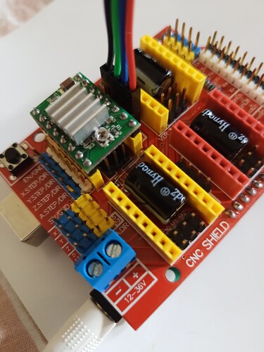

  • Arduino Uno R3 board , using CNC shield to connect the stepper motor which is NEMA 17 ,and there is a driver to control the stepper motor on top of the CNC shield. Could you please assist why the stepper motor won't start? The V settled for 1.5V (based on calculations find it online)

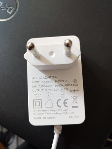

This is which reworked but also tried a simple just running code. The power supply goes directly to the board which is a AC/DC 12 V adapter. The driver has been changed to 1.2V based on internet searches.

The real important information is: how many amperes can this power-supply deliver?

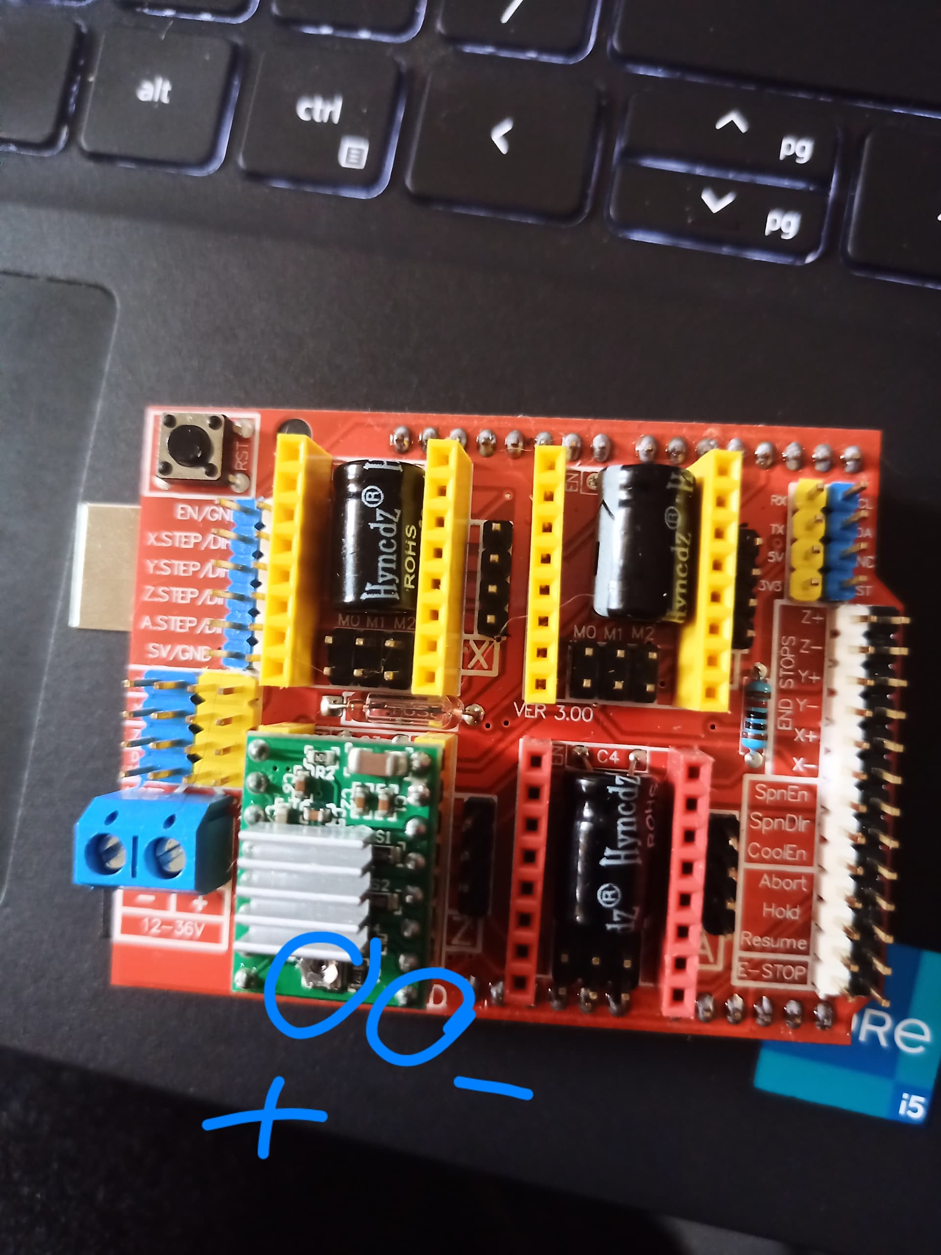

Thank you StefanL38 for the answer. The driver A4988 current limit of the reference voltage. Reworked means when first checked the original code which link provided in the beginning of the post there was lot of error.
The red (positive) connected to the part where you can change the reference voltage and the black (negative) to the first pin next to this reference voltage "button" . It was tried between 0.6-1.5 V no luck. Based on calculations it should be 1.2V if the informations are correct from the web.

This is a pic where was measured by multimeter

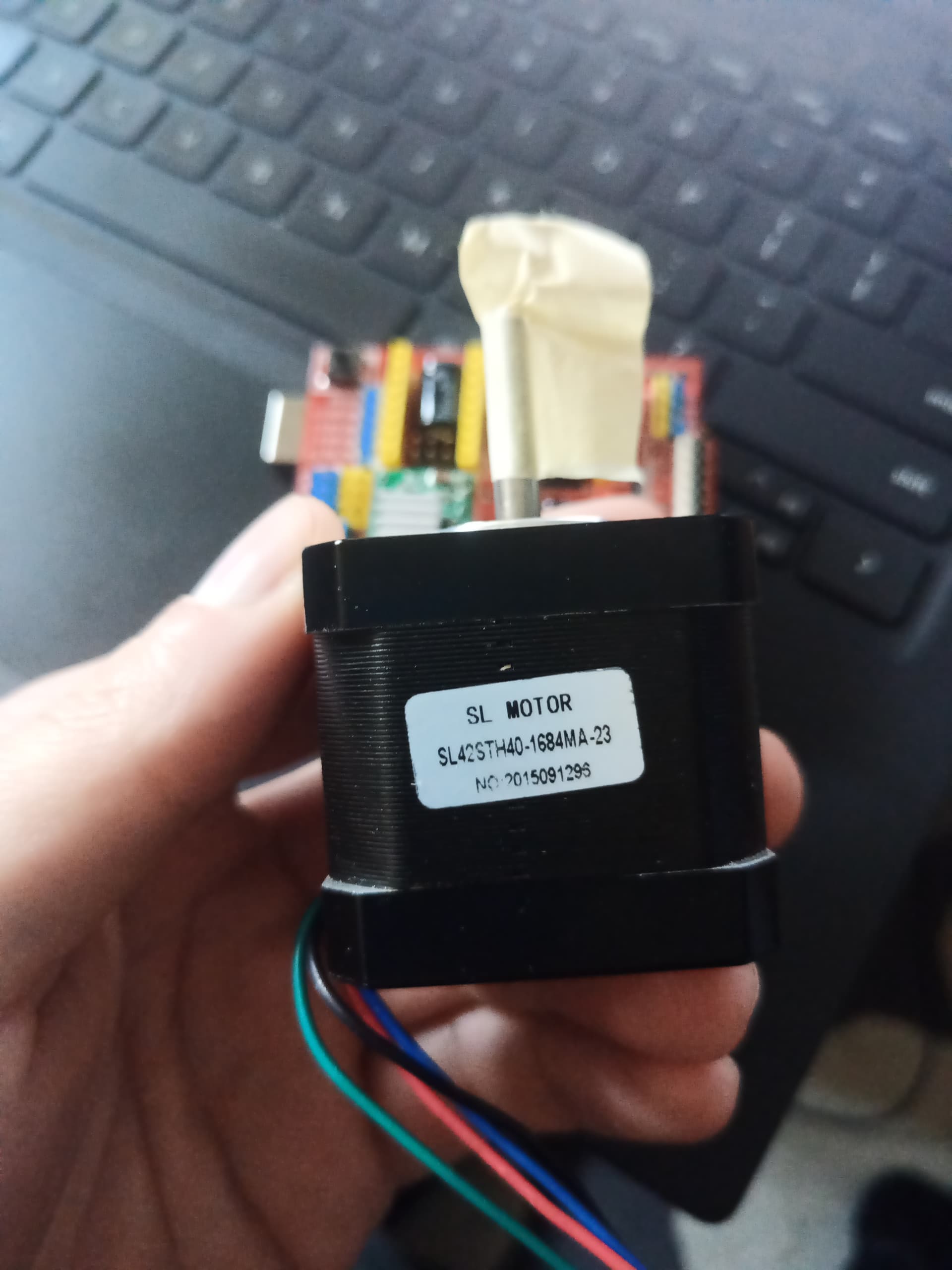

Thank you. Never was disconnected and also checked the motor with multimeter. No error.
This is the second motor btw. I thought the issue with the motor but still not working.
I am happy to give more information but because this is the first time using this I don't have much experience, so please ask and I will answer for all questions.
