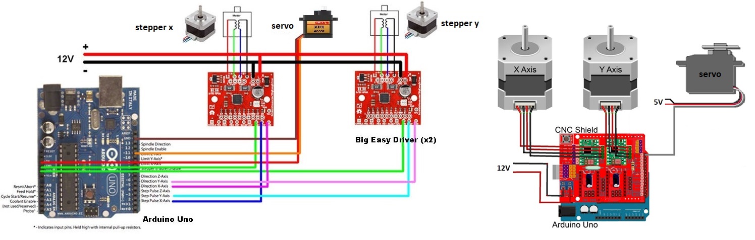

I have the cnc shield connected to the arduino, driver plugged to the X slot on the shield (en pin next to reset button).
I have 4 drivers, one seems to work normal (the one I am using for my tests, set from 0.3 to 0.75v as I was testing things), one only goes up to 0.32v and the other 2 stay at 0.0v, the good one works on all four slots on the shield, same thing for the 0.32vref driver (so guessing I have 2 dead and 1 malfunctioning).
I uploaded grbl 1.1 without problem, arduino is working fine and gives back info when sending $$.

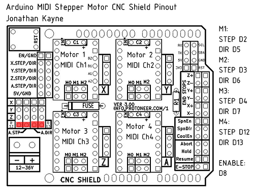

Thank you for the reply. Yes, this is one of the sketch I tried, as far as dir/step pins, I went from this for the driver to this for the shield showing that Dir should be pin 5 and step pin 2 (still new so I hope I got that right).
Yes, I always make sure to disconnect both power supply and usb (not sure if needed but just in case) before to change or disconnect anything.
Also went through this page which had good info (mostly the same I found everywhere, except my motors still aren't turning): https://lastminuteengineers.com/drv8825-stepper-motor-driver-arduino-tutorial/
I searched for the enable pin to find out what it was, from what I understand, All Enable pins are linked to the arduino pin 8, which I tried to set to both low or high adding it to your sketch:

From the diagrams, it should be pin 5 and 2, unless there is a different diagram somewhere, but just in case, I just tried:
Slot X: Pin 5 and 2, then pin 6 and 3 then pin 7 and 4 (2 times each setting pin 8 LOW and HIGH)
Then moved on to slot Y and Z and repeated the same test (Those pin pairs are all the pairs for the different axis).
I also checked the wires from the motor, it matches correctly, each coil wires are next to each other and go to 1A/2A and 1B/2B
it seems everywhere I look, I always find the same pin for the different axis like this one:
Or this one:

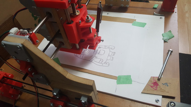

Turns out none of the drivers work, I know that because once I got my new drivers/shield, I plugged everything in like the last one and everything worked straight away (crazy right ?)
My cnc is plotting just great right now till I figure spindle details.
