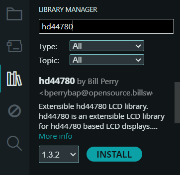

I would strongly suggest using Bill Perry's hd44780.h. It is available through the library manager.
It is self configuring for both i2c address and driver chip wiring variations. It is plug and play.
There is a diagnostic sketch to run if there are any issue.

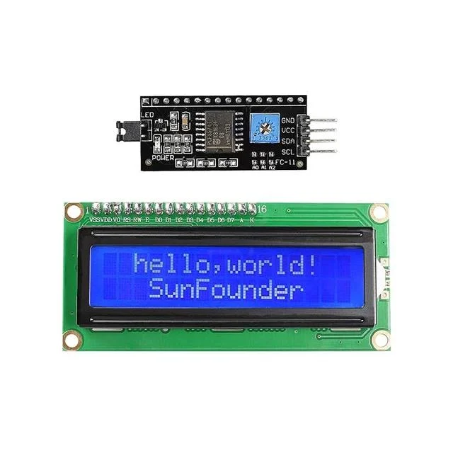

My guess is you have one of these LCD displays:
Would that be what you have and please post an example of your code.

Does it look like the image I posted? The I2C board in my image?
Ron
"Serial adapter" is insufficiently precise.
LCD adapters have been made (and are popular) with both UART and I2C "Serial" connections (and SPI, too.)
If you have an I2C adapter, there are many libraries that will let you use the LCD.
If it's a UART adapter, you probably need to set up a softwareSerial and refer to the particular adapater's documentation for "commands" (AFAIK, UART adapters are less "standardized" than I2C adapters. They were popular back in the "BASIC Stamp" days, when you didn't have I2C, but could send UART data on any pin with a simple "SEROUT" command.)
Yes. Identical.

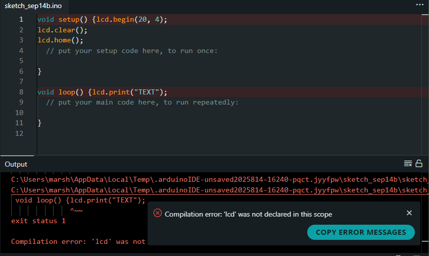

Please post your code using code tags as described in https://forum.arduino.cc/t/how-to-get-the-best-out-of-this-forum/679966#posting-code.
Please post your error messages in the same way using code tags.
Based on the error message you have not defined an LCD object called lcd. As suggested install one of the many libraries for an I2C LCD and look at examples.
The suggested HD44780
or e.g.
Note
You can have both installed at the same time and play with them. The first one has the advantage that it's actively maintained while most of the others ain't.
