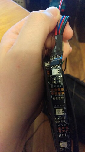

Looking for some help trying to hookup my ambient lighting. I was using the Adalight method to start this out since I am running it directly from my computer, but my LED strip isn't lighting up correctly.
I have Arduino Uno, WS2801 5m, 5V 10A PSU, from the input end: strip CK connected pin 13, strip SI connected to pin 11, GND to GND. There are separate 5v and GND wires connected to the same place as the connector which I have connected to a female adapter +/- to my PSU.
The LED strip is supposed to light up R/B/G before going blank and following the Processing code. Only the first 9 lights will flash R/G/B, the 10th and 11th will stay solid White and get really hot quickly. Sometimes parts of the rest of the strip will light up random colors, sometimes it won't.
I have additionally tried an external power to the Arduino, just because I had power issues with previous projects in the past and figured it couldn't hurt.
To my knowledge the WS2801 strip should only be powered from the INPUT end and be able to power the entire strip, a friend used the same strip with a Pi and only powered from the Input with the same PSU.
I've attached a few photos, any help would be appreciated.
I can't see the Arduino! And it's too dark to see much. You need to take it outside in good daylight to take photos.

Sorry, it would not let me upload all of the pictures previously. I do not have 5v directly from strip to arduino, it wasnt needed in the adalight instructions. All of the power is coming from the external psu, the power I'm talking about for the arduino is for the plug beside the USB port, not any pinouts.
