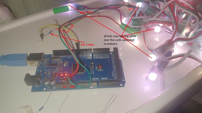

Hi everyone i just got my WS2811 led strip. and i want to use the code of noiasca but without success the leds are still light on the same I used the example proposed by fastled, also without success. below my connection to the led strip and arduino
Add a 10k resistor from the Arduino pin that is producing the data stream, to ground. The LEDs should stay off until the code effectively programs them otherwise.
Hi noiasca i used your code and it works like a charm. the problem was the wrong way for the data wire i used the other side of led strip and surprise it works, for the power i used only arduino power but i will use extenal power be cause i will use 198 leds in my real project.
