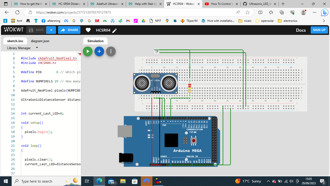

Hi There. I am trying to create an LED strip that lights up as you move closer and further away. I have taken the code from a video on you tube.
I am using a Elegoo Mega 2560 R3, an HC-SR04, and a WS2812B 5meter strip from BTF-lighting. in the diagram below the LED strip is powered off the breadboard where i have an external 5v 40A power supply connected, and there is a capacitor in line. the DATA to the LED strip is from PWN 6.
Sorry I have no idea why it would not work, and no idea how to get it to work so any advice would be helpful. I feel like i may just be missing something really simple.
Many thanks

Those are addressable LEDs - you don't control them with PWM!
There is a link to code in the video - why don't you just use that?
I did
the code above
is the from the link.
OH are you saying they should be from a Digital PIN.
on the elegoo R3 it looks like digital pins start at 21.
No. All pins are digital pins (starting from 0). Analog pins can also be used as digital pins.

the only difference I can tell is that my LED is powered from the breadboard 5V supply.
and not the 5V PIN on the Elegoo.
Do you have the ground of your external supply connected to the Arduino ground?
yes. the GND of the power supply is in the breadboard and it comes off the BBoard into GND 1 and the HC-SR04 GND into the GND2 on the Elegoo. There are 2 GND PINS on the Elegoo.
imagine the button is the power supply, and the LED is the strip.
only GNDs in this pic.
it all looks like this.
again the button is the power supply, and the LED is the strip.
also the is a capacitor where the5v and GND come off the board into the strip.
Can you just leave out getting the entire thing to work all at once, and just get one pixel on the strip to turn on?
Have you connected the right end of the strip to the digital output that is to control it? Sounds like a dumb mistake, until you make it. Ppl do…
All you need is begin, setPixelColor and show, maybe even turn on pixel numbers 1, 2 and 3.
All in setup() with an empty loop() function.
Also, after you
pixels.show();
Stick in a delay(300); in case the code is so fast you don't even see the pixels for the very very very brief time between show() and clear().
