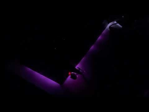

This is cool looking and all, but I've burned through 5 rolls of leds. They work correctly for about 10 minutes on average and start freaking out.
I'm using 4 runs of leds, cut and soldered so I can make the 90deg turns.
The first section of leds always seems to be fine, but any that are added and soldered past the first section, after about 10 minutes, they start flickering and eventually just stop working.
As seen here...
