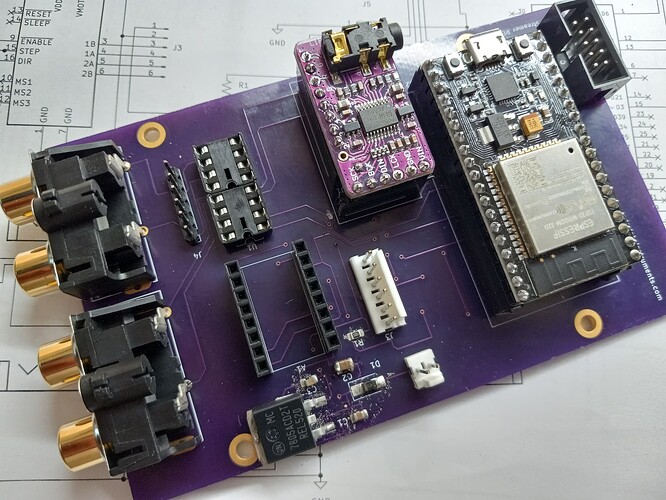

You'll need to use a DAC that takes an I2S output. If you want to run this code directly on an ESP32, you could probably output to the internal DAC, but the sound quality is crap.
I used a HiLetGo PCM5102 I2S DAC (next to the ESP32 board) on this project and the audio is very good.
Ignore the solder spatter near the regulator...
These boards can directly drive a small (very small) speaker. There is an IC onboard that takes care of that and many moons back I had one of these screens and the audio demo's worked with a speaker attached.

out = new AudioOutputI2S(0, 2, 8, -1); // Output to builtInDAC
That's the line I'm not so sure about. There is indeed a built-in 8 bit DAC on the ESP32 but I don't recall its interface being I2S. When you put the audio output into I2S mode, I thought that it only outputs I2S signals, expecting an external DAC.
Or at least that's what I remember from the project in the photo (a custom car stereo).
