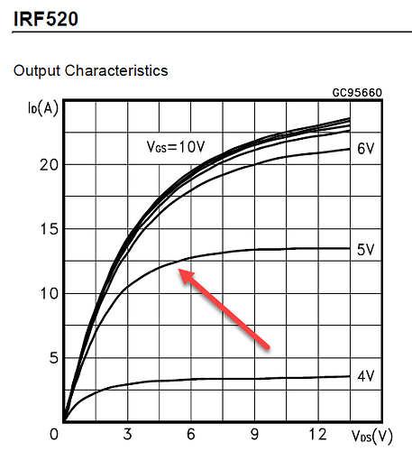

The spec for the IRF520 says it is perfect for logic:
"Input Switching Voltage: Suitable for 5V microcontrollers."
And just from where did you pull out this "spec"? :astonished: Because it clearly is not.
https://forum.hobbycomponents.com/viewtopic.php?t=1872
Also, the data sheet puts Vgs(threshold) at between 2-4v.
That parameter is where the FET turns off if you go below it. It is not the voltage you have to apply to turn it on fully.

Saturation is only applicable to bipolar transistors not FETs, it is caused by putting more current into the base than it needs to turn it fully on.
Grumpy_Mike:
Showing how much I forgot from Uni, recognise everything, remember almost nothing. However, it does work with a logic level signal.
This came up, because the closest thread I found used a pnp to basically reverse the logic, which also would solve the "never off" problem.
Well it might function but the FET is not at its lowest resistance therefore it is burning more power than it needs to be. This could cause excessive heating. You are getting away with it because your current is small and maybe you don’t notice the excess heat.
Grumpy_Mike:
