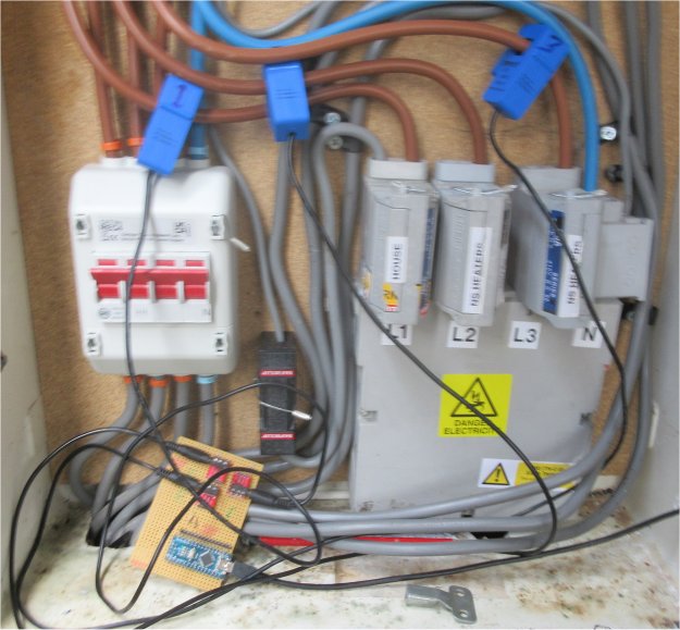

I used an arduino nano with three 100amp SCT_013 Current clamps to monitor three phase grid usage, e.g. showing overnight consumption
I have a Tesla Powerwall and solar panls so minimal grid use thru the day - at midnight the Powerwall starts charging and night storage heaters switch on

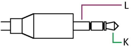

AFAIK the SCT013 does not have a I/V resistor built into it, although your schematic does show it. The datasheet however only shows a TVS diode.
this will be the result when I started the program and the sensor.
connection in current sensor
I tried many times on the other sample codes yet the initial record has a value., and only this code I uploaded has presented "0" as its initial value. yet I dont understand why is it not responding when I uses the SCT-013-000 sensor

I used a circuit similar to sct-013-030-to-measure-watt to offset the SCT-100 ground with 10Kohm resistors - this gave me a sinewave around approximatly 2.5V
code for 3 phase device is

I have checked the SCT-100 results using a clamp current meter and readings are within a couple of amps w
photo showing configuration
the three current readings are sent over USB to a PC program which plots the results
