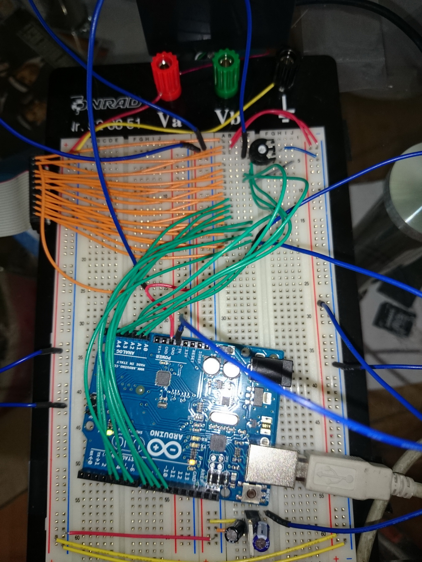

Hello
Attatched, the images. I don't think you'll see much... :disappointed_relieved:
As you can see, for the -10V i use an Battery, so i have a 12V source.
Constructor call:
U8GLIB_T6963_240X64 u8g(8, 9, 10, 11, 4, 5, 6, 7, 14, 15, 17, 18, 16); // 8Bit Com: D0..D7: 8,9,10,11,4,5,6,7, cs=14, a0=15, wr=17, rd=18, reset=16
thanks...
Maybe i missed this, but how did you actually add your -12 V?
  • of the battery must be connected to GND
  • to the one and of the variable pot.
I have not really seen this on your picture.
Oliver
Hi
I generate a -12V tension with an lm7912 (Picture 4). But i'll try it like you described.
Good night!
Edit: I found my fault... I'm actually the dumbest person alive... :roll_eyes: Such a big hand, it needs for a facepalm for this stupidity doesn't exists... I really thought, i could connect the lm7912 to +12V and GND and it generates - 12V... That hurts :sweat_smile: I'll do it with +12V as GND when i'm at home...
