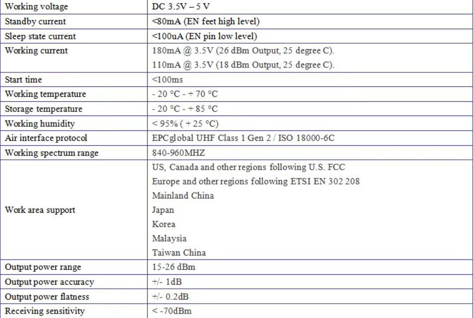

Please post the link to the datasheet, not the seller.

That device needs some 200 - 260 mA. Does the spec for the controller support that?
Yes, the antenna is connected and I think the board is able to supply at least 200mA of current to it.
What does the spec say?
A common rule is: Don't use the controller as a power supply.
