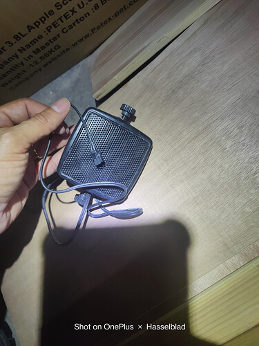

Is it possible to connect one of these speakers to the yx5300 with 3.5mm connector?
do I need a power supply? if so how?

Since the socket is a head phone jack, you will need a powered/amplified speaker.
Too many unknowns...
Do you have specs for the audio board? You'll never get it to work without some "instructions". There is a headphone symbol so presumably it can drive headphones but a speaker probably needs an amplifier. And of course an amplifier needs a power supply (or batteries).
It looks a little unusual for an Arduino audio board... Usually there is an SD card slot where the audio files are stored and the Arduino is simply a controller to select the track and start/stop playback, etc.. Is there an `SD card slot on the back?
Have you tried headphones?
That's a passive speaker. It's only got two wires (no power supply connection) and it says "4-Ohms". It needs an amplifier or a board/chip with a built-in power amplifier.
"Computer speakers" are normally active (they have a built-in amplifier) and they will work with almost anything... They work with a headphone output or the line-level outputs from a CD/DVD player or TV, etc.

I will get an amplifier
