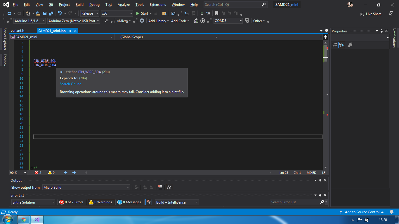

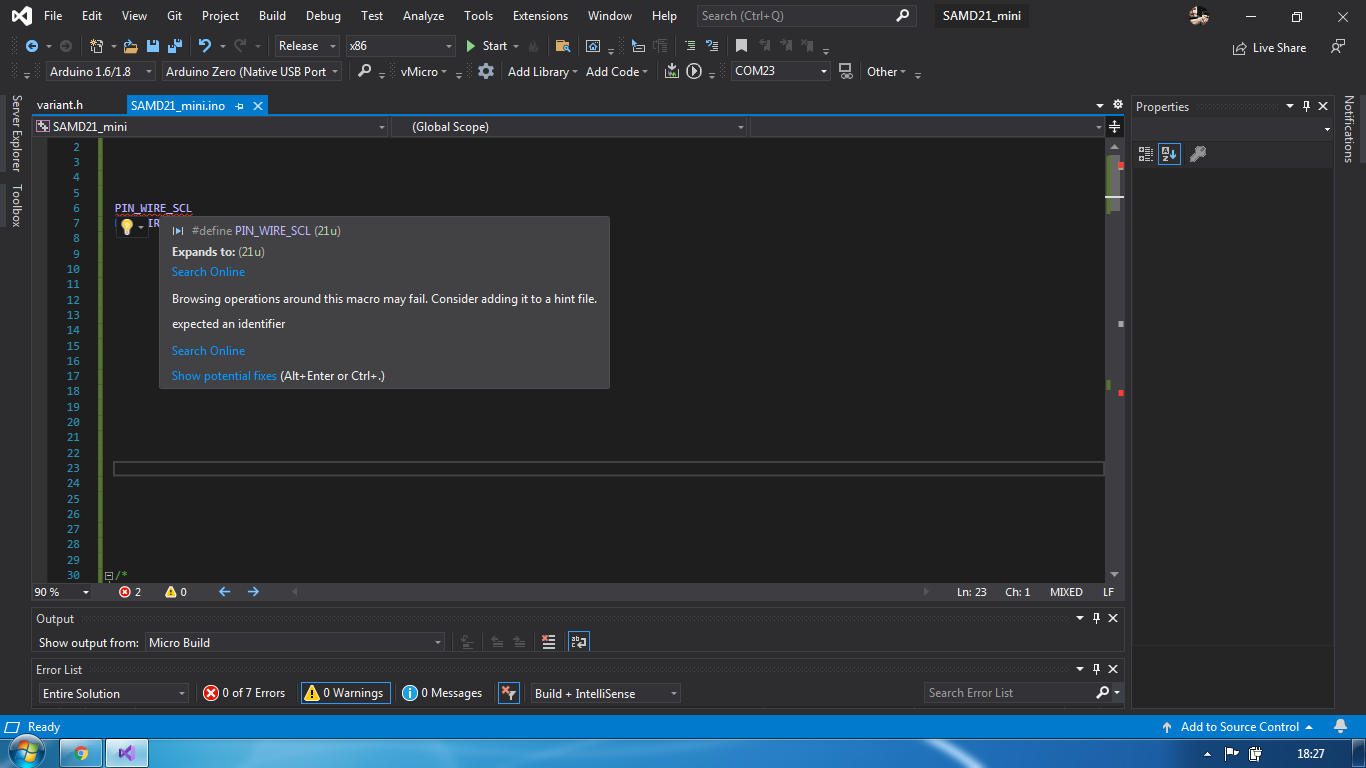

Pretty sure D19 D18 should say D21 D20
You mean for the SCL/SDA pins? Yeah, that looks like a mistake.
You can also refer to them via PIN_WIRE_SDA, or just SDA.
