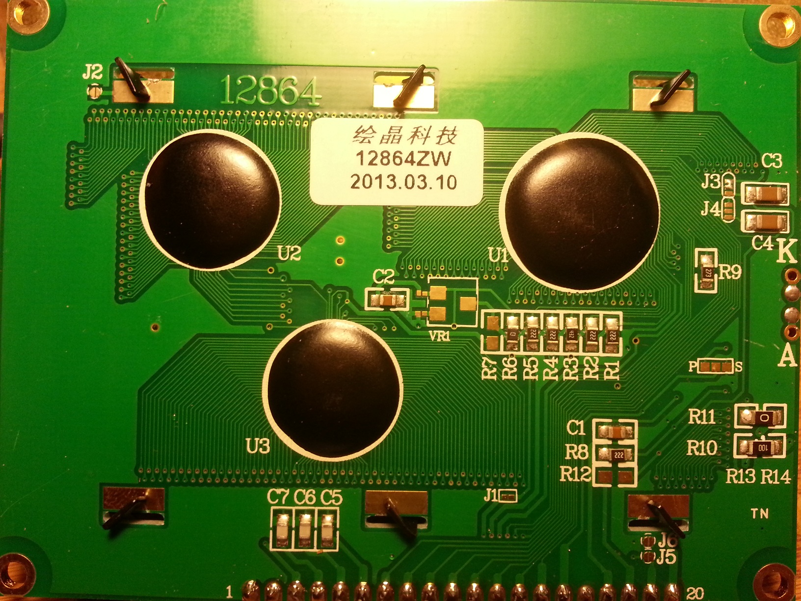

I cannot get a 128x64 display working. Given the markings on the back, "12864ZW", I believe the datasheet is this: http://www.digole.com/images/file/Digole_12864_LCD.pdf
Problem 1: can't set the contrast. Unfortunately the datasheet doesn't say how to do it. With a 10k VR wiper connected to the V0 pin, I've tried connecting the other VR pins to: VSS/VDD, VDD/VOUT, neither combination worked. They all give the same result as leaving V0 floating. So I presume contrast has been pre-set on the module.

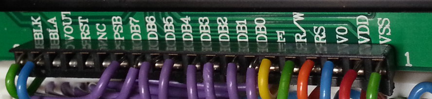

Problem 2 (Main problem): No data I send to the module seems to do anything. The only way I can get any change in what's displayed is by holding the reset pin low or letting it float high. When I hold reset low, as per the photo, the whole screen is blue, I presume that means all pixels are off. When I let reset float high (or hold it high) as per the other photo, it seems all pixels are on (white). Being optimistic, to me this suggests at least that the contrast is adequately pre-set.
The pin connections I've used with the Arduino Nano is as follows:
LCD -> Nano
VSS (1) -> GND (12)
VDD (2) -> 5V (19)
V0 (3) -> NC
RS (4) -> D2 (11)
R/W (5) -> GND (12) (puts into write mode)
E (6) -> D3 (10)
DB0 (7) -> D4 (9)
DB1 (8) -> D5 (8)
DB2 (9) -> D6 (7)
DB3 (10) -> D7 (6)
DB4 (11) -> D8 (5)
DB5 (12) -> D9 (4)
DB6 (13) -> D10 (3)
DB7 (14) -> D11 (2)
PSB (15) -> float high (puts into parallel mode)
NC (16) -> NC
RST (17) -> D12(1)
VOUT(18) -> NC
BLA (19) -> 5V (19) via 470ohm resistor
BLK (20) -> GND (12)
