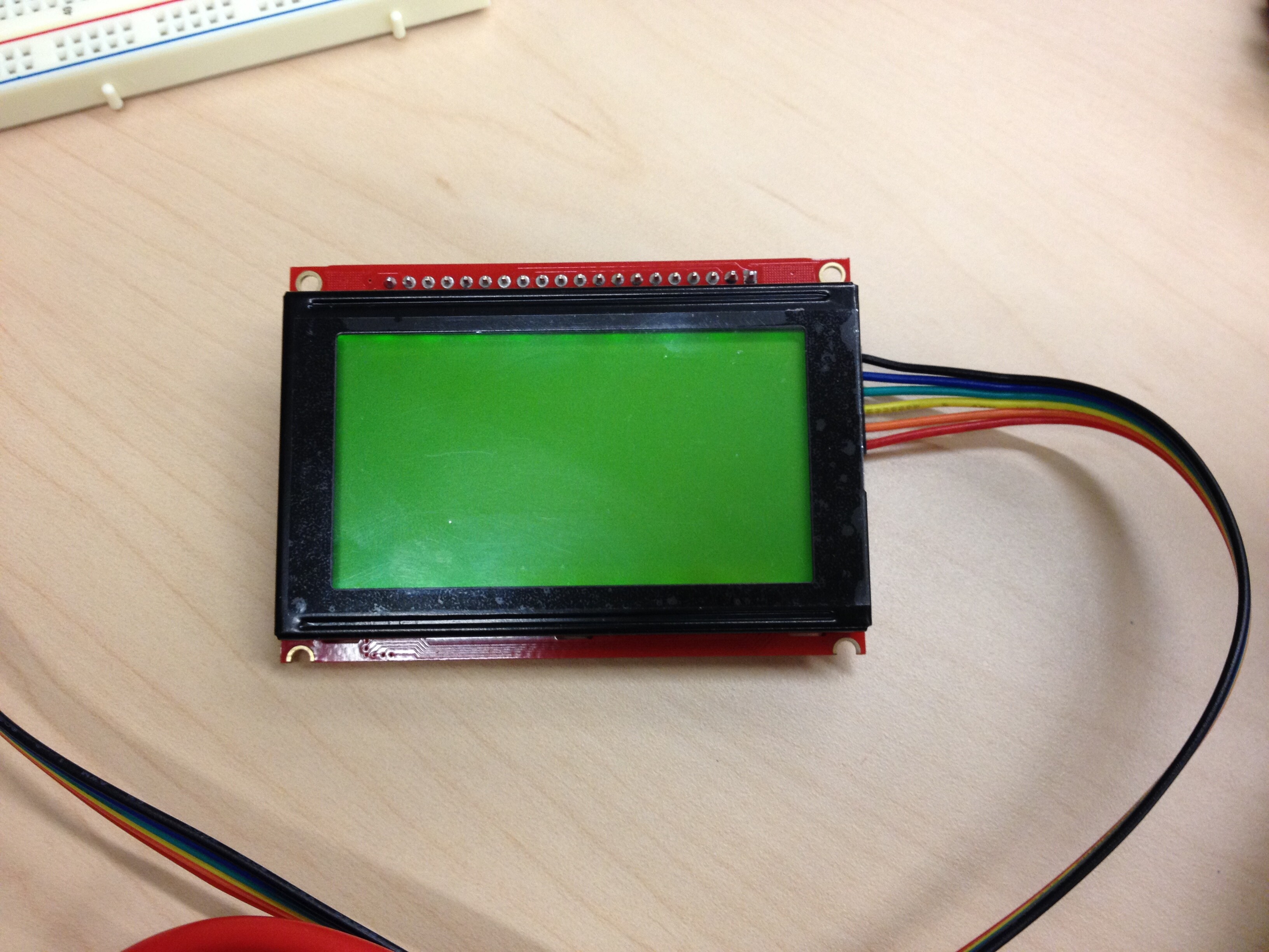

Hi! I'm working with the Redboard from Sparkfun and their 128x64 serial LCD (https://www.sparkfun.com/products/9351) and I'm running into an issue.
I have tried several different example codes, and the display has not been working even though the backlight comes on when powered. Most recently, I tried running the SerialGraphicLCDDemo (see attached). As usual, when I first plug it into the Redboard, the backlight comes on. Once I upload the program, nothing happens for about 5-10 seconds, and then the backlight goes off and gradually comes back on again. After that, more nothing.
So, I am not sure what the problem is or how to go about fixing it. I've tried looking for some answers, but haven't found anything useful. If someone has an idea, solution, or website with the answer I missed, that would be great!

Could you post a picture of the LCD, Fully connected and turned on? That could give us more information on what is wrong, and how to fix it!

Oliver - I think you are right about the backlight demo working. I got LCD with the backpack pre-assembled from Sparkfun. And there is a var pot on the back of the backpack which I've tried playing around with, and it doesn't seem to change anything.
Goldfile - I attached a picture of the LCD when it's hooked up and on. Hopefully you can see that the backlight is on, but there is nothing displayed on the LCD.
I have the V_in and GND on the LCD connected to the V_in and GND on the arduino, and I have the RX of the LCD connected to digital pin 3 on the arduino. I tried running the code with the RX connected to TX (as it says to do in the code), but then the backlight demo wouldn't even work. I found on some forum to try hooking it up to digital pin 3, and that's when the backlight demo started working.
If everything is powered, then you should see the pixels of the display of the var pot is at one of the extreme positions. It might be required that you see from the side to the display (not from the top), If you really do not see anything, then i would assume, that the negative voltage is not working.

LCDs require some strange extra voltage. If this is not available, you can not see any pixel. I have never seen a damaged voltage converter, but it might be possible. Maybe you have some wiring error.
You need to clarify this statement.
The arduino has a "V in which is an unregulated input for the onboard regulator, and a +5V pin.
It's possible the display has the same arrangement.
We need to know if you are connecting two unregulated inputs to some power supply and if so what is the
voltage of the PS. If you mean to say Vcc of the Display instead of V in, then we need to know what is the
correct voltage for the display Vcc . Is it 3.3V or 5V ? If you mean you are connecting the Vcc of the display
to the +5V of the arduino, then you need to state that.
Please clarify.
What are the voltages involved and are the Vin pins or Vcc pins ?
