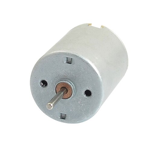

I did an image search and found this, may be it, generic motor case.
But Amazoooooonn don't give any specs.
But in their Q and A, (why do you have to ask for the specs, I NEVER use Amazoooon)
Question:
What's the max current draw of this motor?
Answer:
Depends on your load and Voltage. If it's 6 volts, at no load it's about 400 mA. I was operating with a load that cut the rpm's in half (a fan) and it was about 1.7 amps. So I'd say somewhere between 0.5-1.5 amps. Use a variable voltage supply with your load to figure it out, or a multi meter
By Cory Z. on October 11, 2015
Hope it helps. OP hasn't even said where he got the motor.
