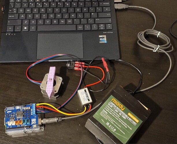

My setup is as follows:
  • Arduino Uno connected via the USB cable with the VIN pin cut (bent for now)
  • Arduino MotorShield Rev 3
  • The Stepper motor below
  • Power supply to the shield is a 12.8V battery connected via a 12/9V DC-DC converter. So 9V to the shield
If I remove the extra power supply and let the VIN pin connected to the Uno, it all runs fine but it's very weak. With the VIN pin disconnected and external 9V supply, the motor runs normally for a short while then it starts shaking and the motorshield seems to overheat.
Could you please help me identify what is wrong, perhaps the driver board is inappropriate for the stepper motor I am using. Thanks in advance for any recommendation or advice.

The L298 driver will work with that particular high impedance (34 Ohm) stepper, but will not deliver full power to the motor.

That is expected with a typical low impedance stepper, for which the L298 is not designed.
Check whether you do in fact have the high impedance motor described in the motor data sheet you posted. Measure the winding resistance, which according to the data sheet is 34 Ohms.
Thank you very much for this! I just checked the motor and it seems it's 1.5 Ohms per winding which explains the behaviour. Looking at the website where I purchased it, it seems that I received an identically sized motor (42x34mm), rated 2.25V, 1.5 Ohms and 1.5A... I will get it replaced and hopefully it will work like in the tutorial.

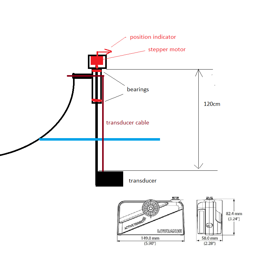

The motor will move a 1.2m x 10mm stainless-steel shaft inside the pole, which will be mounted at the side of the boat, and will go about 40cm in the water. At the submerged end, there will be a transducer like the one below:
I presume a 2kg/cm motor will work when the boat is stationary but as soon as I'd start moving the boat, it will be overloaded. The pole would be in the water for boat speeds of up to 10km/h. For the moving boat scenario It would need to be much more powerful so the ideal specs would be:

If you are using all the 25 foot below water than you will almost certainly require a much larger stepper when traveling. Either a NEMA 34 or larger. And almost certainly a much better driver capable of running such a large stepper capable of at least 3.5 amp or more. The 24 volt supply will almost certainly be needed too.
Consider also allowing the project to disable the stepper when drag becomes too much so allowing to to become more like a free rudder if you are moving at speed.
OOPs missed the 40 CM bit bit that is still a lot of drag at speed.
sorry, it will be about 40cm under water. The 25ft length is just the transducer cable.
Yep I noticed but as a mech eng. I would still like to see a larger motor from the get go.

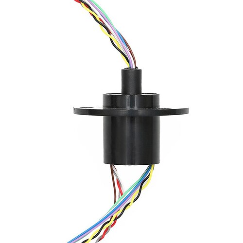

Also bear in mind you probably want to do one of two things with the cable.
A. Limit its rotation to 350 degrees to prevent tangling inside the tube and eventual breakage.
B. Use a slip ring connection at the top to allow it to rotate as much as you want.
But clearly the slip ring would have to be a slightly more waterproof version.
EDIT...The lower bearing would also have to be a double sealed waterproof type unit. suitable for the type of water you are working in. Saltwater will require a different bearing from freshwater in some cases because of corrosion factors.

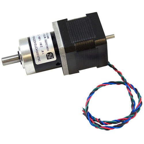

The transducer works almost like a video camera so it would rotate left/right to scan for (moving) targets :smiley: The speed of rotation of about 20-30rpm would be sufficient so, if possible, I would trade off some speed for extra torque. Would a geared motor not work in this case?
It is possible that a geared stepper would work for the sort of speeds you are looking at.

Would the A4988 driver work with the geared stepper motor such as the one below:
Specs are 1.7A at 12V, 30kg/cm, 20rpm, which should hopefully be sufficient.
