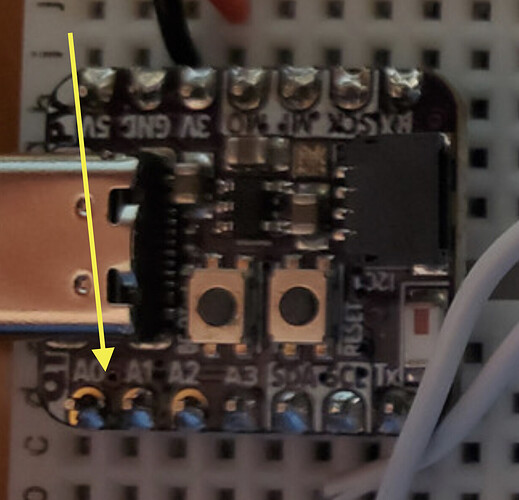

Hi. I'm running Windows 10 with PlatformIO and tried this simple "Hello World"

I get this:
I tried a second display and the outcome was the same. I also tried the other I2C connection and also got the same thing. Any help is appreciated!

Try running an I2C scanner sketch to confirm the display’s address.

first thing I did. The address is correct
Okay, if you got a response with the scanner sketch then that proves ~90% of the hardware .
Suggest you confirm there are I2C pull-ups are on the display PCB.
Experiment with adding 4.7k on both SCL and SDA going to 3V3.
BTW, the soldering on A0-A3 is iffy but this should not affect I2C.
This is interesting...I used a different EMC-32 board and got the same thing. I did what you suggested on the 4.7K pullups...no effect.
