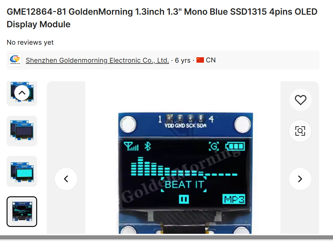

Hi everyone,
I'm using a 1.3" OLED display (I2C, SSD1306 driver, 128x64 resolution) with an Arduino Uno. I followed the standard wiring and used the Adafruit SSD1306 and GFX libraries, but nothing is showing up on the screen — not even the Adafruit splash screen.

Wiring:
  • VCC → 3.3V
  • GND → GND
  • SDA → A4
  • SCL → A5
What I've tried:
  • Verified all wiring
  • Used different OLEDs and jumper wires
  • Checked I2C address with I2C scanner (it returns 0x3C correctly)
  • Tried other example sketches like ssd1306_128x64_i2c from the Adafruit library
Still no display output.
Any ideas on what might be going wrong? Could this be a library issue, a contrast setting, or something I'm overlooking?
  • Do you have a 0.96" SSD1306 or a 1.3" SSH1106
  • Give us a Link to where you bought it.
  • Your sketch works fine.
  • If you are using an Arduino UNO REV3, try Vcc = 5V
I am using this
That says SSD1315, not SSD1306.

  • The SSD1315 probably needs its own unique Library.
  • The SSD1306 or the SSH1106 work well with their associated Libraries.
  • You could try the Adafruit_SH110X.h library to see what happens.
Your sketch works correctly on my small OLED, which is labeled 'NFP1315-45AY' on the PCB side. So perhaps you are not using the correct OLED as @PaulRB pointed out.
Or, more likely, you are indeed using the wrong library.
I have another larger OLED labeled GME12864-77 which I'm using with the U8g2lib library.
To remove any ambiguity/confusion, show us a photo of both sides of your module.
