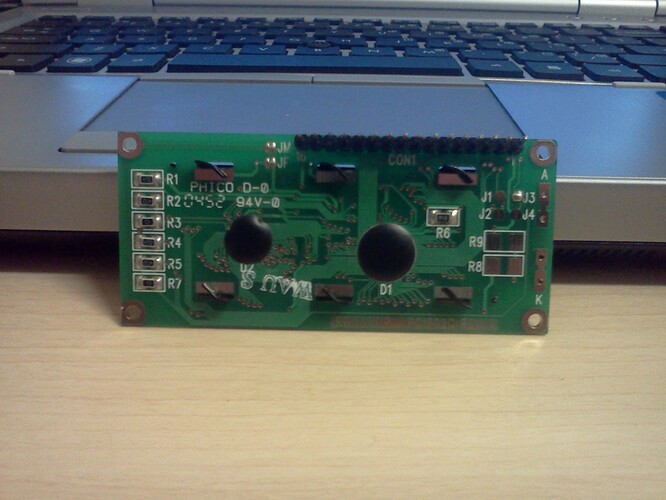

So I have had this 1602 display laying around for ages and I haven't ever been able to figure out why. I'm sick of it so I decided I'm gonna do whatever I can to make this thing work.
I've been using this and I have loaded its sample program up and it still won't do anything.
I don't even see the pixels turn on or anything. Its just completely idle. Any ideas?

The display I'm using is a POWERTIP PC1602C Rev A
It also has PHICO D-0 94V-0 on it.
From what I've found it should be the same pin out as a normal 1602 display.
I have no idea what the problem is, that's why I'm here asking...
Where are the pins located with respect to the display? Some of the Powertip displays have the pins at the lower left and those typically do not have the same pinout as a normal display.

Just like the picture.
That is what I assume to be the proper way, seeing as how the text is upright.
That looks 'normal' to me.
First get the backlight working (pins 15 and 16), you will probably need a current limiting resistor in one of the backlight leads.
Next connect the the power and the contrast (pins 1, 2, and 3) and see if you can adjust the contrast to get blocks on the top row.
Don't bother with the Arduino until you get this working.
After you get the blocks then connect the six connections to the Arduino, connect R/W (pin 5) to GND, and try the 'hello world' demo sketch.
Post photos if you have problems. I'll check back in the morning to see how you did.
