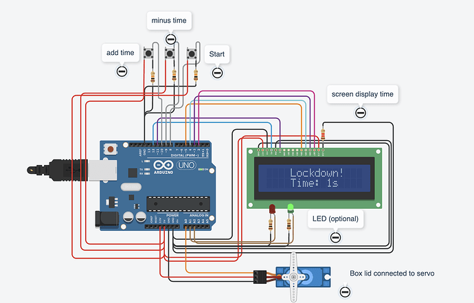

16x2 LCD only showing boxes on the top rom
Im making this project for me to learn on my own.
Its a timeout box for your phone during study sessions.
But the LCD is not working as intended but when i put it together and coded it in tinkercad first it all worked fine
Im trying to no have as much big
parts in this project so instead of using a potentiometer im using a resistor( 1.2 kΩ) for a more simple build.

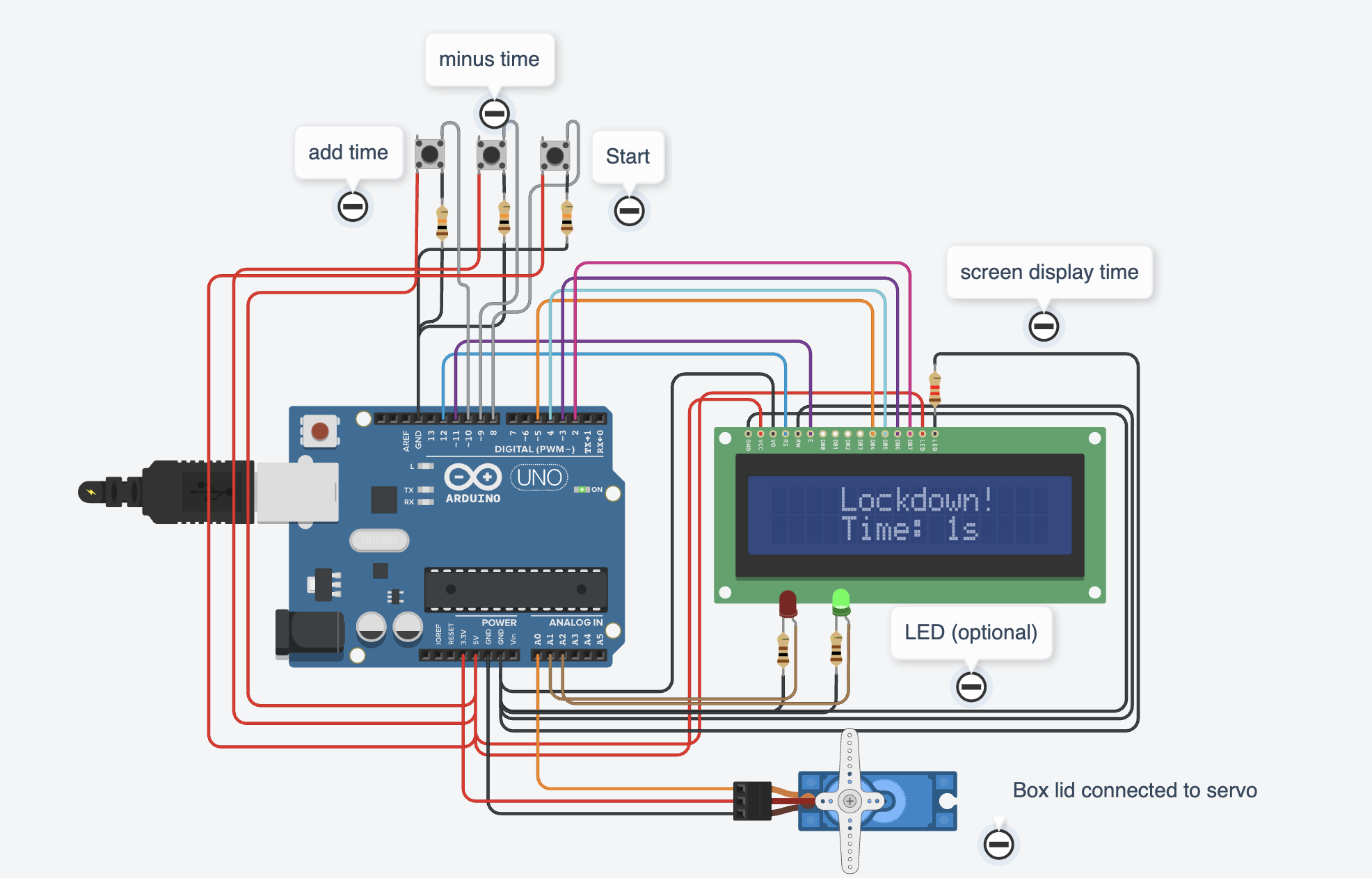

Image of the circuit:
image of wiring on tinkercad:
This wiring is also just the lcd with the other components removed

image of the full circuit:
I would like to know how to fix this and the mistake i made at this moment.
One row of boxes is usually a sign of the LCD not receiving the proper initialization commands.
That can be caused by incorrect wiring, not soldering headers, incorrect software, etc.
Can you tell from the picture what's wired where? I ask because I certainly can't. It's just a tangled mass of Dupont cables to me.
  • Do not power the servo from the Arduino 3v3 pin ! :scream:
  • Servos should be powered by an external 5 DC power supply.
  • Where is your contrast potentiometer ?
Adjust the contrast with the potentiometer... which you didn't connect! :man_facepalming:
Hi, @adamlikes_blue
Welcome to the forum
Start with just the example code that is with the Library.
Write your code in stages and get each stage working, in this case remove everything except the LCD and run code that ONLY uses the LCD.
You have V0 connected to GND. Place a 470 ohm between V0 and GND. The 1.2K is on pin 16, which is for the backlight.
Connecting V0 (LCD pin 3) to GND is not his problem. The 470 ohm resistor might help the contrast but it won't fix the fact that the display is not properly initialized.
I suspect that R/W (LCD pin 5) not being connected to GND is more likely to be his problem.

The potentiometer is not needed in this case.
but then if R/W is connected to GND what will replace pin 12
Arduino pin 12 is connected to LCD RS (Register Select) which allows your program to switch between sending commands to the LCD or sending display data to the LCD.
The LCD R/W (Read/Write) pin could be connected to an Arduino I/O (Input/Output) pin which would allow our program to switch between sending data to the LCD and reading data from the LCD. Since we generally don't need to read anything from the LCD we just connect that pin to GND which keeps it in the 'Write' configuration allowing the program to write (send) data to the LCD.

The OP used a single resistor.
How many times a day do you need to adjust the contrast.
For the 16 x 2, I use 1k0 and for the 20 x 4 , 1k5 + 1k5 in series and never need to adjust the contrast ever.
Did the OP used the 1k2 ? It is not visible from the photos.
