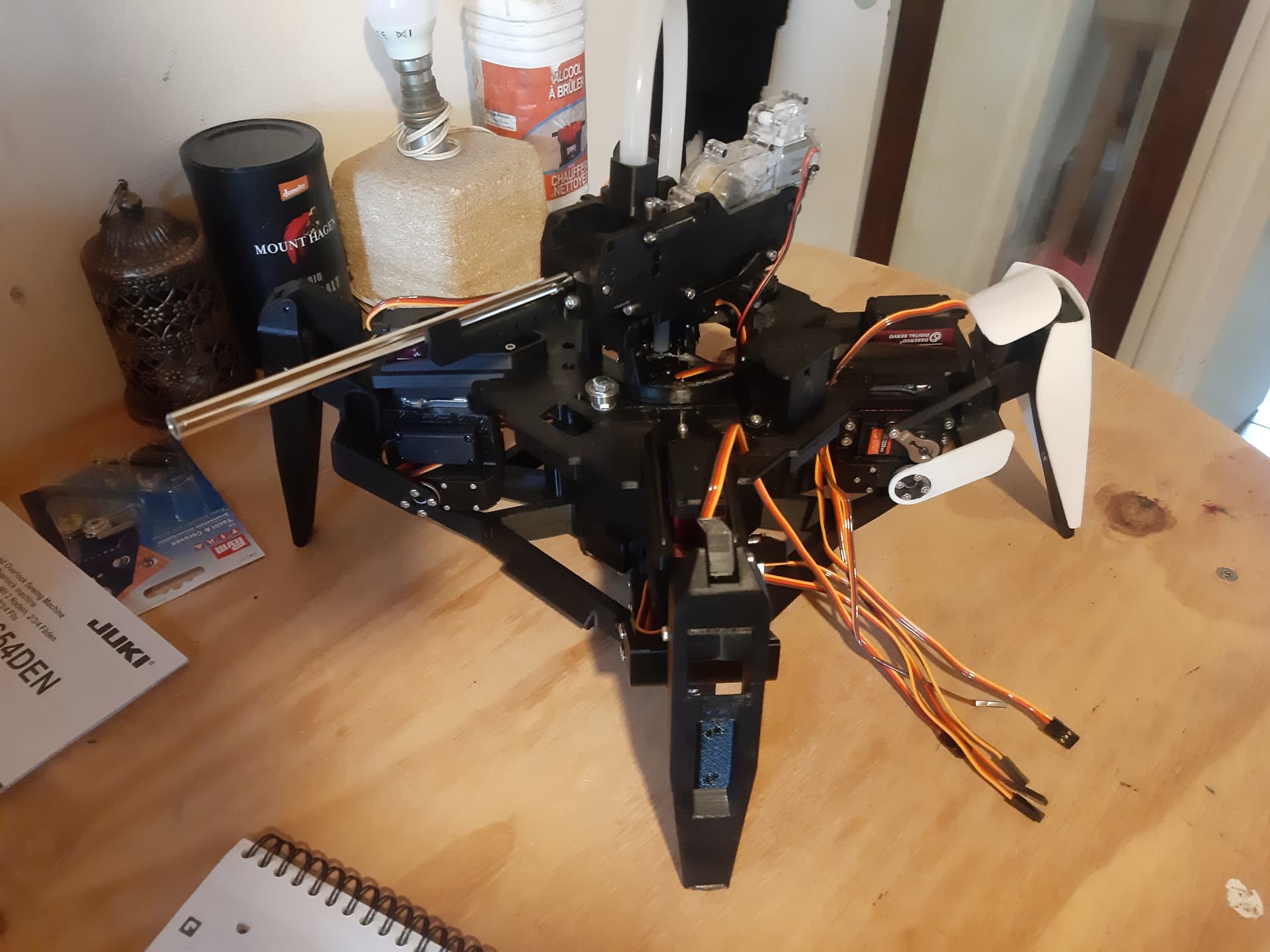

I'm in the process of building a quadruped robot for mech warfare.

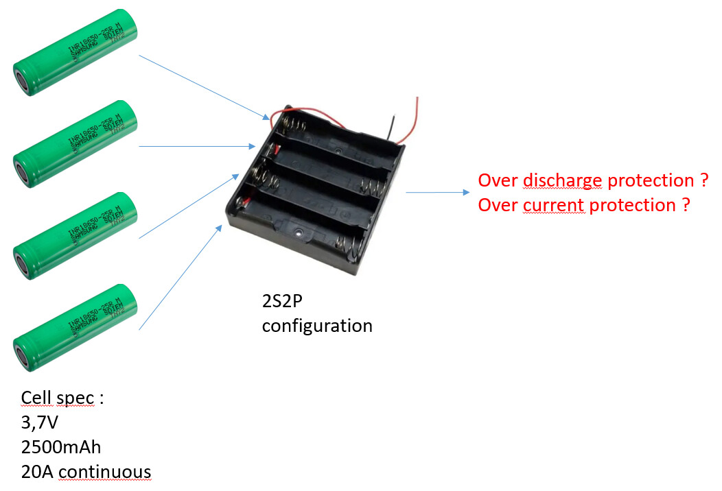

I've figured I need a 18650 style 2S2P battery with 40A continuous to fit my needs, I have found the cells.
I will charge the cells individually on a dedicated charger and load them in the robot using a battery holder (rewired to a 2S2P configuration) (see picture below).
The question is do I need to protect each individual cell from over discharge, or each 2P group or the battery as a whole? And where should I start to try and design the kind of circuit that can take the 40 amps?
Is over current protection necessary?
Thank you for your help.

Why wouldn't it be safe to connect the batteries in parallel then?
Internal resistance.
"Safe" can be "for the life of the cell" as well as "so your experiment does not burn the block down."
EV battery cells are matched in capacity and internal resistance so they all charge at the same rate to the same level, and discharge at the same rate to the same level. Mis-matched cells would charge and discharge at different rates to different levels. This causes imbalance in current and full-to-empty use, and eventually effect capacity.

Also, that battery holder with springs and tiny wires is no go for 20A continuous.
Over discharge current protection could be simple 20A fuse.
Bms boards are not expensive neither heavy...
Wouldn't it be more simple to use ready made high discharge rate 2s battery pack with bms?
Good point regarding the 20amps going through the springs of the battery holder!
Had a rethink after all your advices and I'll go for an 11.1v protected lipo as sonofcy said, it'll make my life easier, just have to redesign the battery cradle of the robot.

The easiest way is to buy a BMS with overcharge/overdischarge protection.
I doubt these cells can provide 20A current per cell. Do you really need 40A?
7 volt x 40amps is alot of power.
Just make sure it's ok for 40amps continuous.
There are 18650 cells that can. But OP was describing 2P for 20amps, so 10A per cell.
Edit: was describing 40 like you said.
