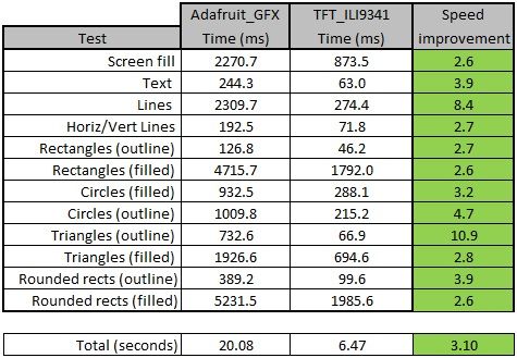

The library should be giving much better performance than that with a Nano. If you run the graphics test the results should be similar to column 3 for an ILI9341 display.
This table is here.
It looks like you are running with a very slow SPI clock rate. Run at 8MHz.
Ah, I see you are already using the refeenced library in post #3 so that is the best performance you will get.
The fonts are optimised for Nano type processors so try the other examples. The trick is to only update the parts of the screen that change.
