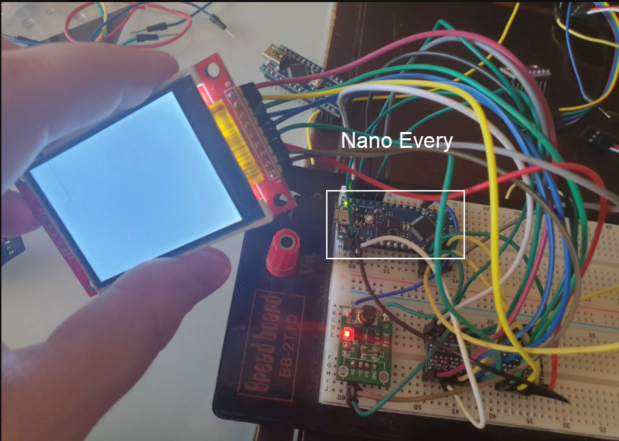

I try to launch demo sketch from adafruit_ili9341 lib on Arduino nano every. Compilling is ok. Connection is ok. Display shows white screen. I have both arduino nano v3 and nano every. Display works fine on nano v3, problem only with nano every.
The configuration of connection is:
SCK - Arduino Pin 13
SDO(MISO) - Arduino Pin 12
SDI(MOSI) - Arduino Pin 11
CS - Arduino Pin 10
D/C - Arduino Pin 9
RESET - Arduino Pin 8
LED - 3.3V / 5V
VCC - 3.3V / 5V
GND - GND
How it can be fixed?

Sketch and photo of wiring in attachment.

​Thanks for advices.
I founded level-shifter.
So I re-built schema with 2 level-shifters and tested with nano v3 and nano every (Sketch the same).
Result:
​nano v3 - ok;
[pre]nano every - white screen.​
[/pre]

While I'm waiting for resistors I built a circuit with level-shifters and 1K resistors. I ran the adafruit_ili9341 example sketch on nano every in HWSPI mode and it's ok. Display works fine without problems.

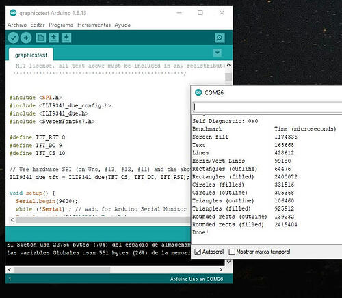

If you use short wiring, correctly connect each point and connect your TFT firmly, you should not see speed reductions.
You must keep in mind that you want to move a screen using poorly optimized libraries like the arduino SPI and although it is good to start with, the original adafruit library requires deep optimizations to get the best possible performance for AVR.
My suggestion is that you use the ILI9341_due library, it has optimizations that allow AVR boards to reach 80 or maybe 85% of their potential.

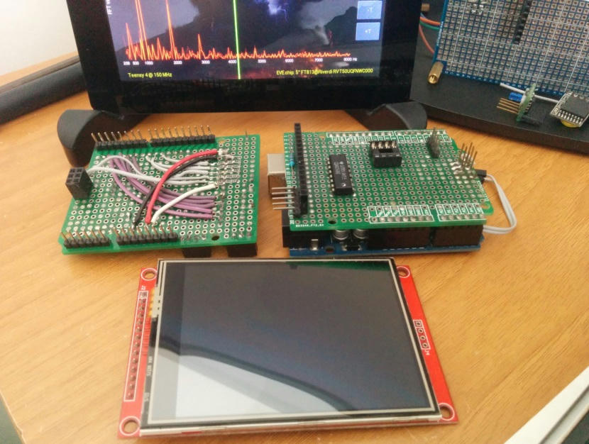

I don't have a nano but I have a UNO, I have the two circuits enabled in their respective shield: a CD4050BE and a set of 10K SMD resistors joined in the form of 5 voltage dividers.
If what you are looking for is a huge processing power in a few millimeters, go straight for a teensy 4 or a teensy 4.1, you have 600 Mhz at your disposal !!
Yes, I am sure that the 10k+20k voltage dividers will work fine on the Uno. i.e. with SPI @ 8MHz
