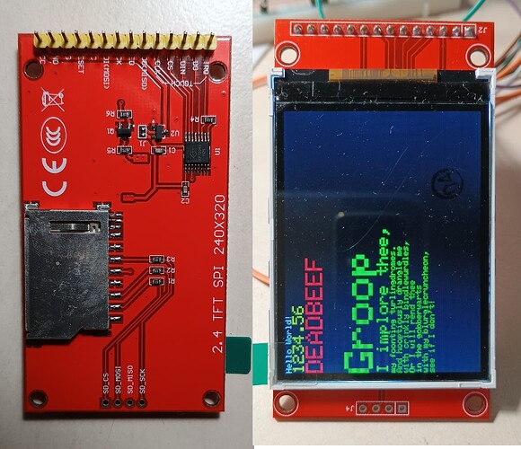

I want to make a project that uses 2.4" TFT SPI 240x320
Even ignoring the logic level conversion issues, the display you show does not have the IC (U1) that is needed on a touch display.
The screen also needs to be one that has the touch stuff built in, and with U1 not fitted, I doubt it has.
Of course you are right. The module shown in the attached forography does not have a touch function.
And I have a question for you: did you run such a module exactly in such a version on the photo, that is, without touch and in version 1.3 ?
Never checked what the 'version number' is on the back of the display.
Buy one and see if it works, then report back.
O.K. ![]()
I don't need to buy because I recently picked them up (2 pieces) and have a problem with them. It looks like they only support 240x240 px and mix colors. A bit strange - I admit. I'll come back tomorrow and post photos. Greetings

I have a similar 240X320 Resolution 2.8" SPI TFT LCD Display Touch Panel ILI9341 labeled V1.2 with the U1 chip fitted - the touch functionality works OK using the XPT2046_touch_library
Here's how 2 modules of an identical display, differing in design (and the absence or not of touch functionality, which probably shouldn't matter), work, connected to an Arduino Nano, with the Adafruit_ILI9341 library. Both display the same image generated by a test program known to everyone modified to stop at that particular image. As you can see, the display without the described version shows everything correctly (according to the program), while the version 1.3 display only supports 240x240 resolution, swaps red for dark blue (and vice versa) and yellow for light blue, and rotates the image 90 degrees. I originally assumed that I was using an outdated library, but I checked that I have the latest one installed, version 1.6.1.
Do you know where to look for the cause ?
