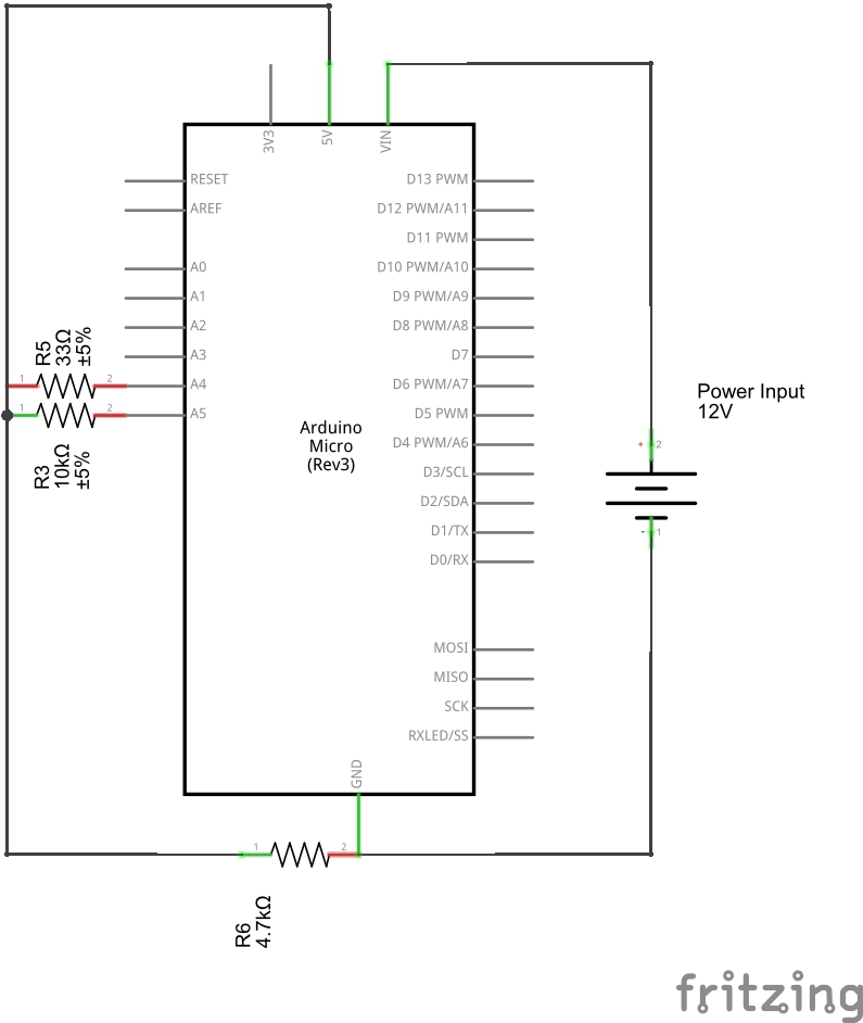

this is my setup, Widerstand = Resistance.

Is the wiring OK ? Im mostly not sure if that is correct as i think it is.
The original Fritzing wiring diagram only has a connection to A5 but your 2 sensor code uses A4 and A3. Presumably you have amended the wiring. Personally I find schematics easier to follow than Fritzing graphics even if they are hand drawn and photographed.
Yeah the Graphic wiring looked shitty when i used A5 and A4, but in the schematics i took A5 and A4. Well then ill try it this evening home and report if everything worked fine :slight_smile: Thanks for your help so far

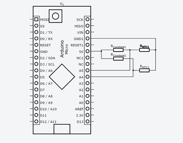

I think the attached file will have what you need to read two NTC resistors.
Tom.... :slight_smile:
So its done, first part at least, im able to measure the 2 Sensors by using the following code and the attached build.
So now ill look into the digital Potentiometer :slight_smile: Thanks for your helps so far guys :slight_smile:
