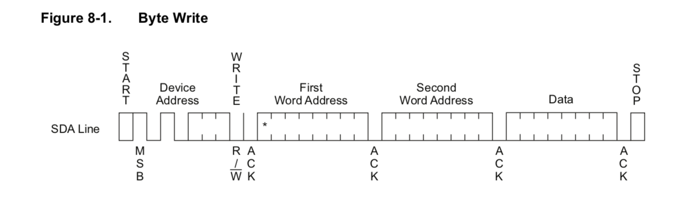

Seem write and read not working... Did I missed something?
You are only sending one byte for the EEPROM address you want to read and write to. You need to send two bytes, that is a 16 bit number that contains the address you want to read or write to.

The first parameter of this function, which is the address of the EEPROM you want to write from is defined as a byte. So what ever you pass into this function will be converted into a byte. So you pass an int into this function and it is converted into a byte!
This is bad because you only ever send a byte as the address. The EEPROM chip needs the following data as defined in the data sheet I told you to read and didn't.
The first word address has a * on the most significant bit, which means that the first word address is the most significant byte of the two byte address you must send.
So the first thing you must do is change the function definition of both read and write functions to a
void writeAT24(int dataAddress, byte dataVal)
Ah, I got it now... I use BOTH "int" as void writeAT24(int dataAddress, int dataVal). it's worked. thanks!
